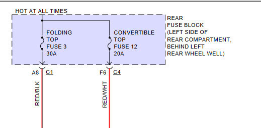

Retractable roof will not close.
Saturday, April 15th, 2017 AT 10:17 AM
HMAC300
MECHANIC
48,601 POSTS
Check fuses in pic then have a mechanic scan for codes as this is run by amodule and there may be a switch telling module not to open.
Image (Click to make bigger)
