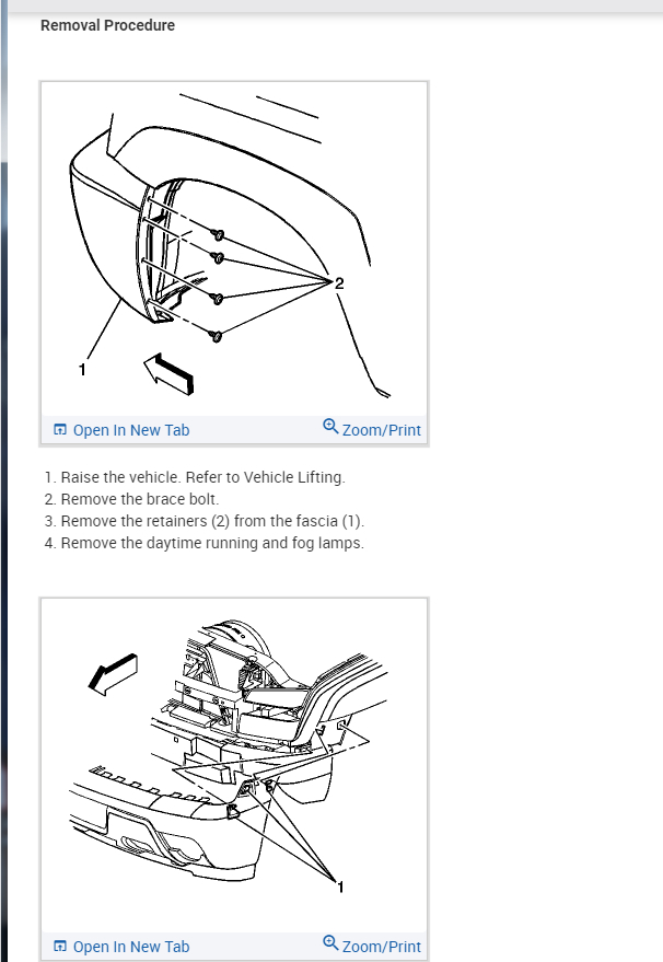

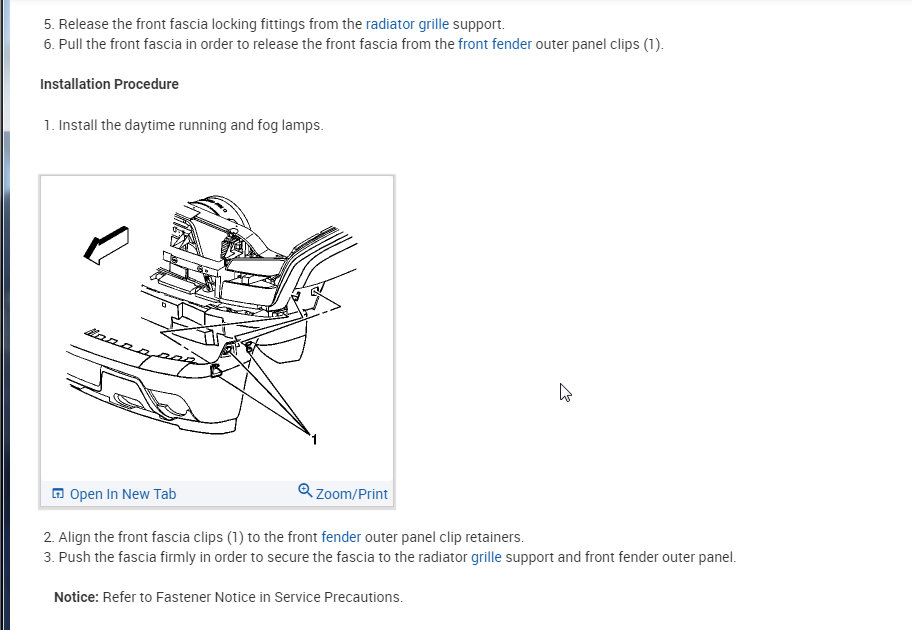

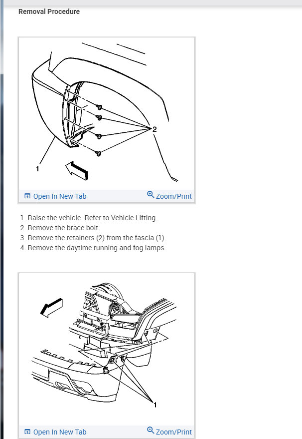

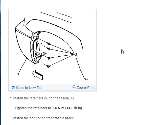

How do I replace the bulb for my daytime running lamp if I have a bumper or a grill on the front of my vehicle? do I need to remove the grille?
Sep 18, 2020 at 10:48 AM
  • CAR REPAIR CONTRIBUTOR
Is this the stock bumper and grill or are they aftermarket? Maybe get a picture of what the truck looks like. It appears they are requiring you to remove the bumper to replace it but let's get a picture of the bumper and the lamps so we can get on the same page. Thanks
Sep 18, 2020 at 10:57 AM
DELGADO KIMBERLY
Aftermarket grille. I call them cattle guards. Bumper is factory.
Sep 18, 2020 at 1:10 PM
DANNY L
  • 5,648 POSTS
Hello, I'm Danny.
No, you don't have to remove the grille. You should have enough room to remove the lenses to replace the bulbs without having to remove the bumper guard. You might have to do some wiggling and manipulation to get them out. Here is our sites tutorial on how to change them:
https://youtu.be/SzS1YYmKP3M
Keep us updated and let us know if you have any further questions on this issue.Hope this helps and thanks again for using 2CarPros.
