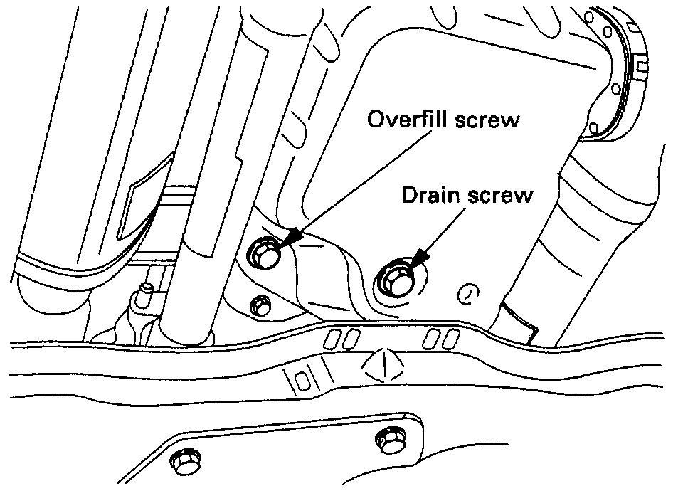

Do I have to have the car running to check it.
Friday, November 2nd, 2018 AT 11:32 AM
  • 110,194 POSTS
Hi and thanks for using 2CarPros. Com.
Yes, the engine needs to be running when it is checked. Here are the directions specific to your vehicle for checking level. See the attached picture for fill (fill and check is the same location) and drain. Do not remove the drain plug unless you plan to refill the system.

1. Park the vehicle on level ground and apply the parking brake firmly.
2. Check fluid level with engine running at idle.
NOTE: Be sure that transmission fluid temperature is below 30°C (86°F).
3. Move the selector lever through all gear ranges.
4. Move the selector lever to "Park".
5. Let engine idle for three minutes and open the overfill screw.
6. Add transmission fluid until it flows out over the overfill screw opening, then close the overfill screw.
7. Let engine idle until a fluid temperature between 32°C (90°F) and 57°C (135°F) is reached, then close the overfill screw.
Torque: 38 Nm (28 ft. Lbs.).
NOTE: Check transmission fluid temperature with a service tool.
