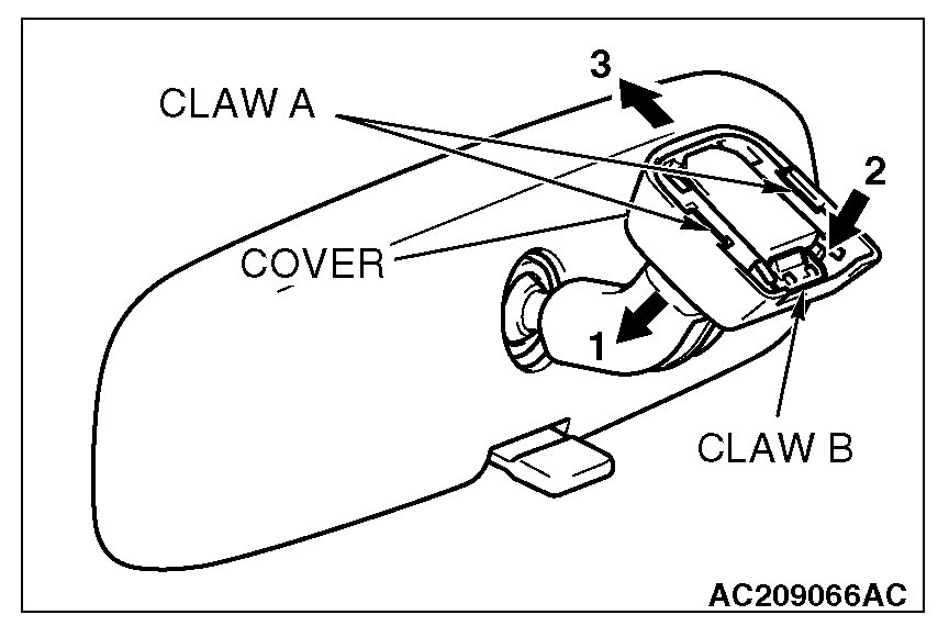

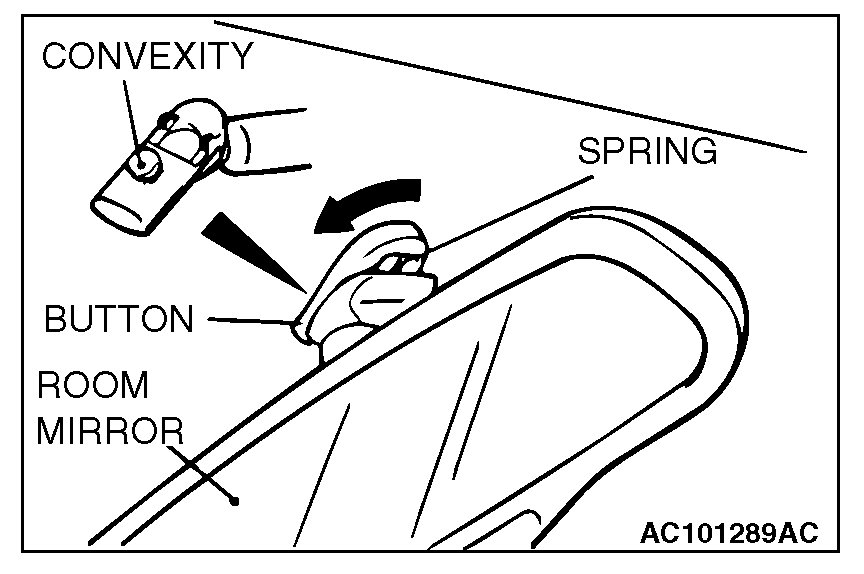

Guys, i just had a windshield replaced in Tampa Florida and the mirror needs to be adjusted and re-glued to the windshield for my height and vision. how do you remove it and remove the bracket from the windshield? question, does it need to be heated up to remove the attachment bracket?

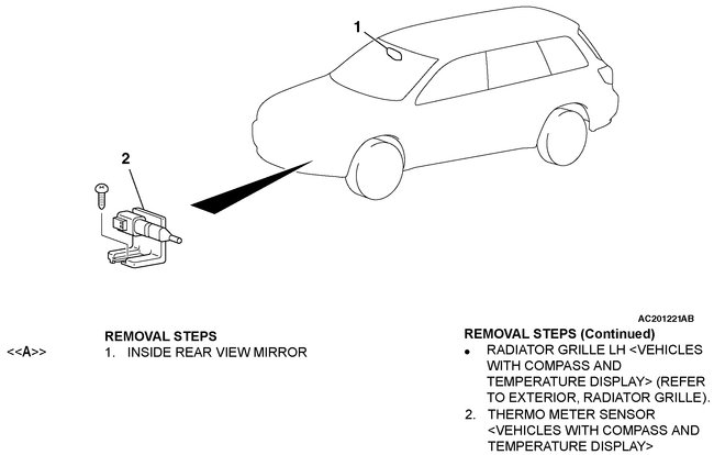

Here are the directions for the mirror itself. There are two sets here because I don't know which one you have. The attached pictures correlate with these directions.
__________________________________________
INSIDE REAR VIEW MIRROR
REMOVAL AND INSTALLATION
Removal Steps 1-2
Picture 1
REMOVAL SERVICE POINTS
[[A]] INSIDE REAR VIEW MIRROR REMOVAL
[Vehicles with compass and temperature display]
Picture 2
Pull out the mirror in the bottom direction after turning it 90 degrees in the direction of the arrow, as shown.
[Vehicles without compass and temperature display]
Picture 3
1. Disengage the claw A and lower the cover toward arrow 1 direction.
2. Push the claw B toward arrow 2 direction to unlock, and pull out the mirror toward arrow 3 direction.
