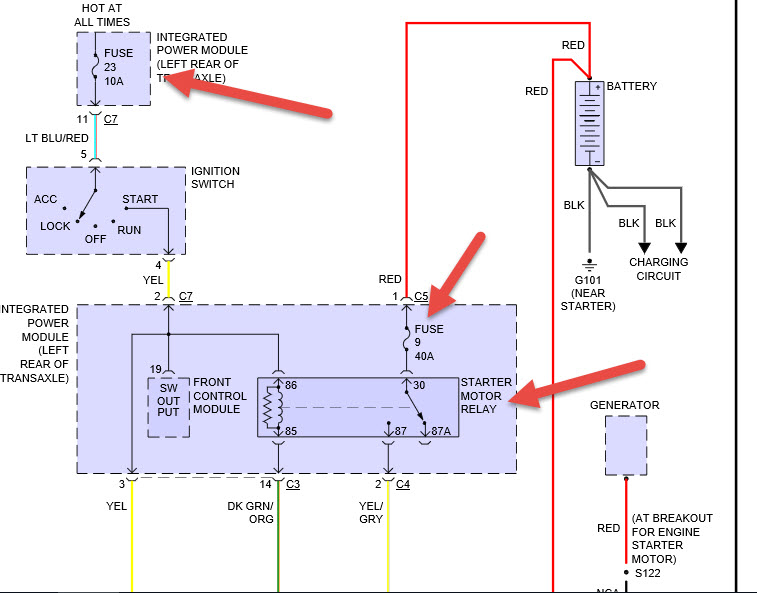

Chrysler Town and Country won't start. Lights, radio and horn works just fine. Even tried to give it a jump but nothing.
Wednesday, January 13th, 2016 AT 11:21 AM
HMAC300
  • 48,601 POSTS
Try resetting security system first if no manual look online. If still not starting check items in pic then get it scanned as it may be the tpim module
