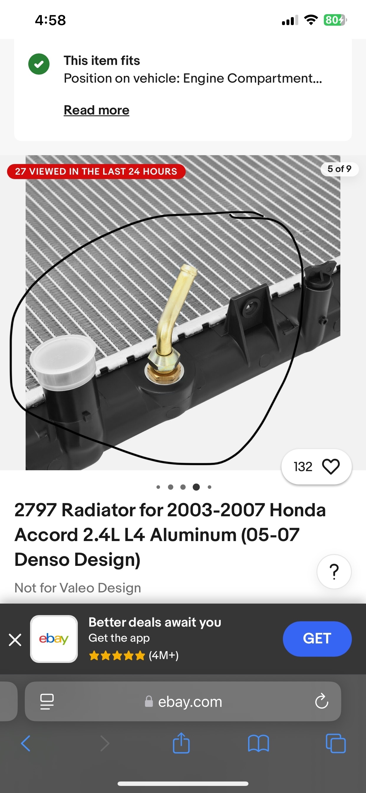

Recently got a radiator. The mechanic said he couldn’t complete the job because the radiator didn’t come with an adapter for this sensor. And I’m unable to find the adapter sold online for some reason.

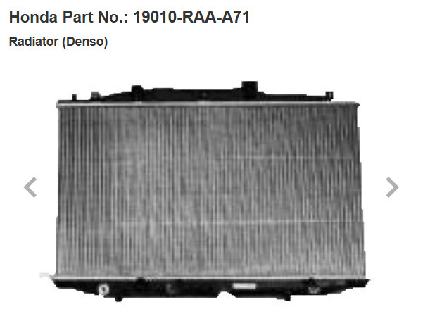

The OEM part number is 19010RAAA71. If you google search Honda part number 19010RAAA71, it will bring up what should be needed for a 2.4L automatic.

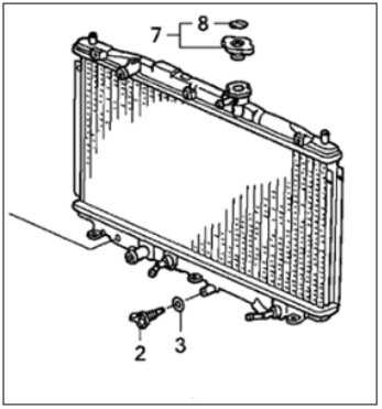

I attached a couple pics below. Do you see the part he is referring to?

Looks like this. It almost seems like it’s impossible to find this part by itself.

That is a transmission cooler line and not a sensor. If you punch in the part number I gave you above, you should be able to find one. Go to Google and type Honda part and then the part number above.
Let me know if you are able to find one.
