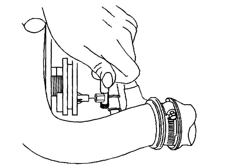

1. Remove the hood.
2. Disconnect the negative battery cable.

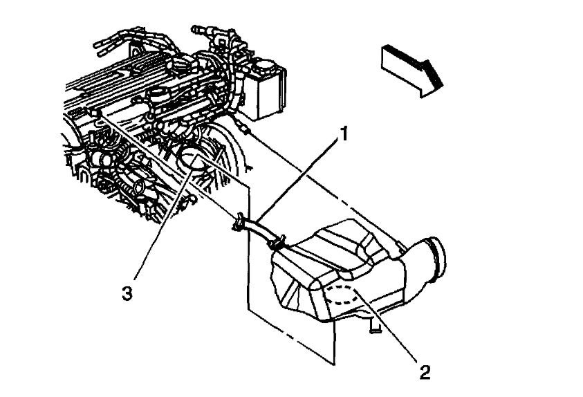

3. Remove the air inlet duct and resonator (2).
4. Disconnect the accelerator and cruise control cable.
5. Disconnect the brake booster hose at the brake booster.

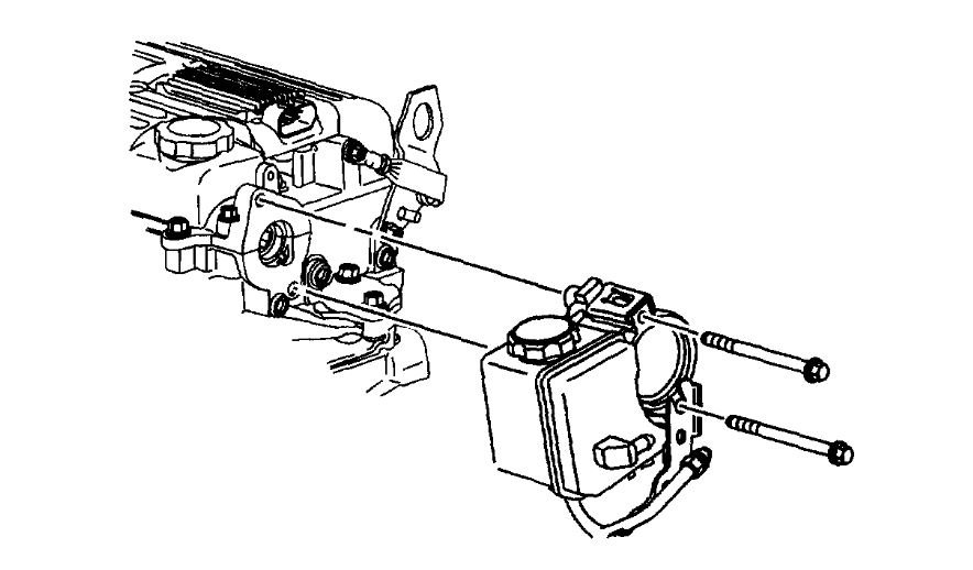

6. Remove the power steering pump bolts and set pump aside.

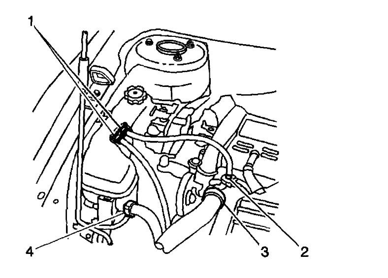

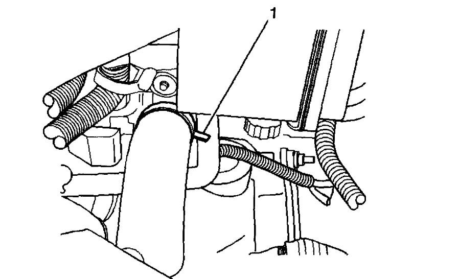

9. Remove the radiator inlet hose (3).
10. Remove surge tank to cylinder head hose (2).
11. Disconnect the surge tank to radiator outlet hose (1).
12. Remove the bolt retaining the surge tank outlet hose to the intake manifold.
13. Remove the radiator outlet hose (1).

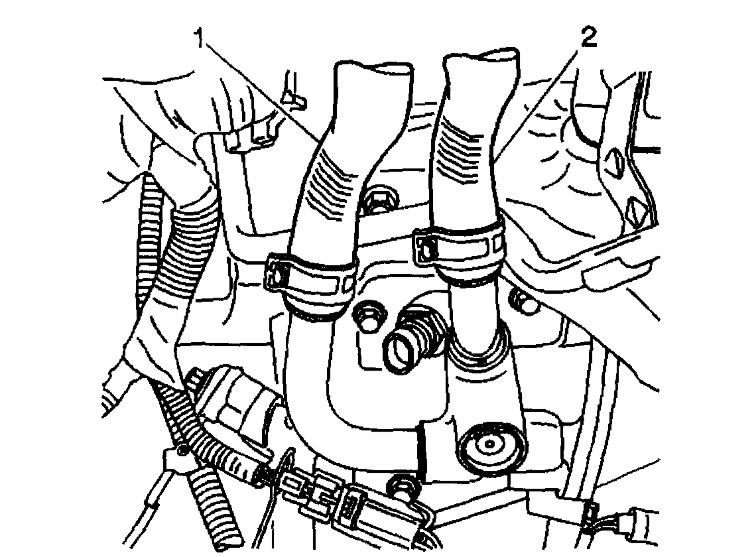

14. Remove the inlet heater hose (1) and outlet heater hose (2).

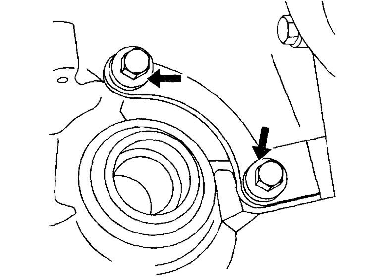

20. Remove the crankshaft balancer.

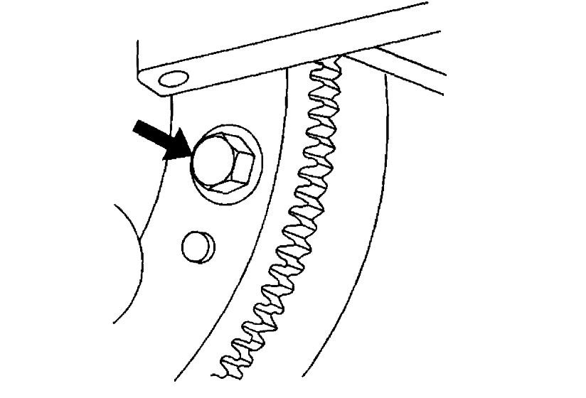

26. Remove the flywheel to torque converter bolts.

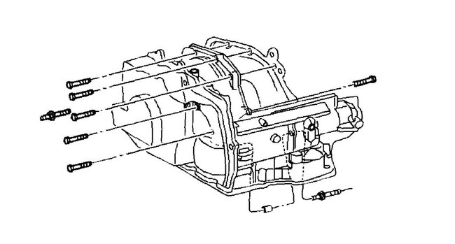

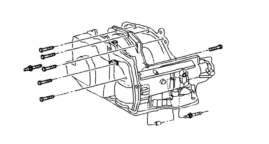

27. Remove the lower transmission bellhousing bolts.
28. Remove the transmission to engine brace.
29. Lower the vehicle.
30. Install J 42451 to the right rear of the cylinder head.
31. Install an engine hoist to the engine.
32. Remove the bolts which secure the bracket to the engine mount.
33. Remove the upper transmission bellhousing bolts.
34. Separate the engine and the transmission.

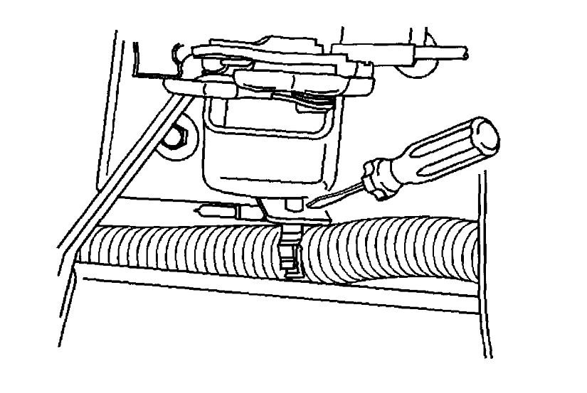

How do you get all flywheel bolts out? Is there a wrong way to hook any electrical wires up or do they only fit on what they came off? It is harder putting other motor in.
Apr 29, 2019 at 1:10 PM
There are three flywheel bolts. You have to rotate the engine to access all of them.
The wire connectors are keyed so they cannot be installed in the wrong position.
