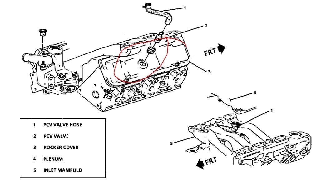

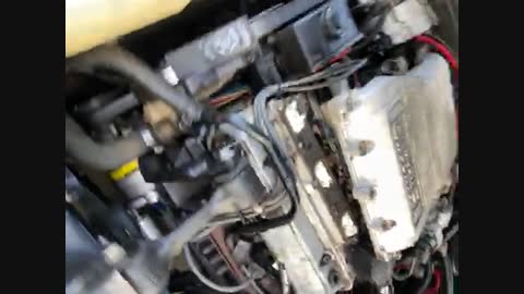

I have the car listed above Cutlass Supreme. It has injector problems at least I think. As I was taking apart the car to get to the injectors I found oil. It wasn’t a little oil it was a lot of oil. It was inside the tube connecting the throttle body and air filter. There was also some inside the throttle body. I cant find a PCV valve. So I’m not sure if I have one or what I should do. Is this even something to be concerned about? Any help would be greatly appreciated thank you in advance.
Tuesday, March 10th, 2020 AT 2:13 PM
7 Replies
Good evening,
The PCV valve is in the back valve cover. I attached pictures for you.

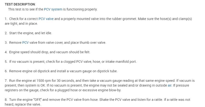

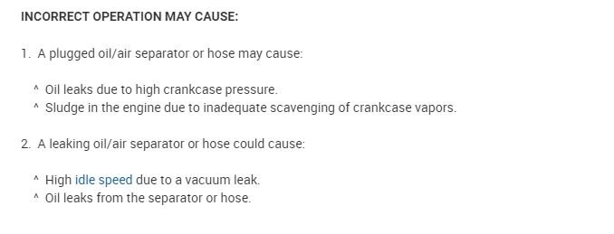

It may be the valve but I doubt it. I think you have excessive blow-by from worn piston rings that send oil vapors back into the intake system.

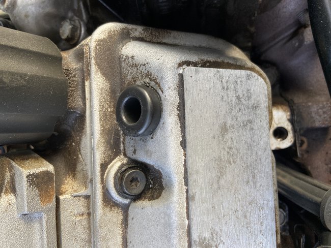

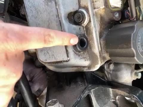

I found the PCV it’s completely missing. I think I should buy one and put it in. Thanks again for the help.
Tuesday, March 10th, 2020 AT 4:31 PM
Okay, install the new one and see what happens.
