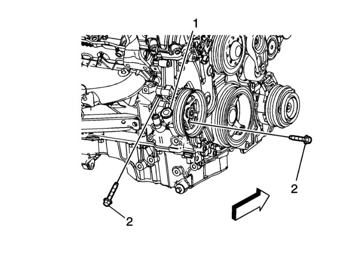

How do you remove the bolts on a power steering pump to remove it?
Mar 12, 2018 at 11:05 AM
  • CAR REPAIR CONTRIBUTOR
Good afternoon.
There are three attaching bolts. Two on the side of the pump that you get from under the car and towards the rear of the engine. the third one you access through the power steering pulley.
Picture attached.
