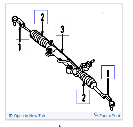

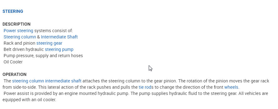

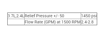

This is most likely one of two things. Either the rack has an issue or the pump is not providing the proper pressure.
The way to find this out is to measure the power steering pressure and see if the pump is performing. If not, then your pump is the issue. If it is then the rack is most likely the issue.
Let me know if you have questions and we can go from there. Thanks
