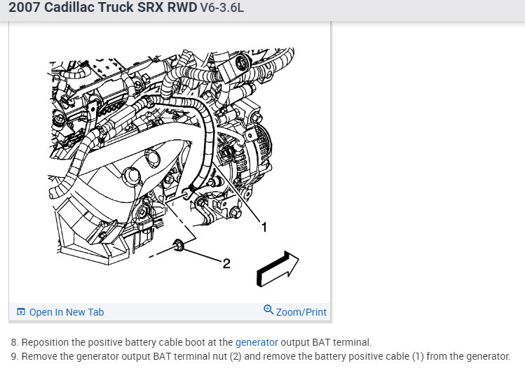

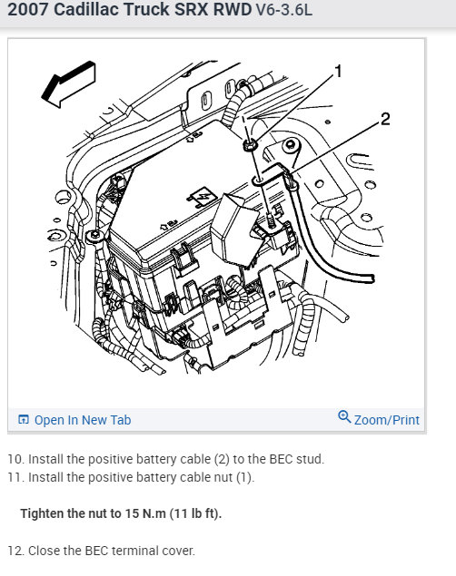

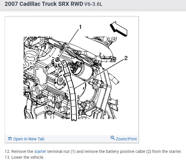

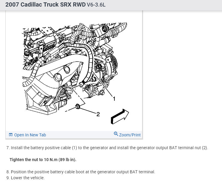

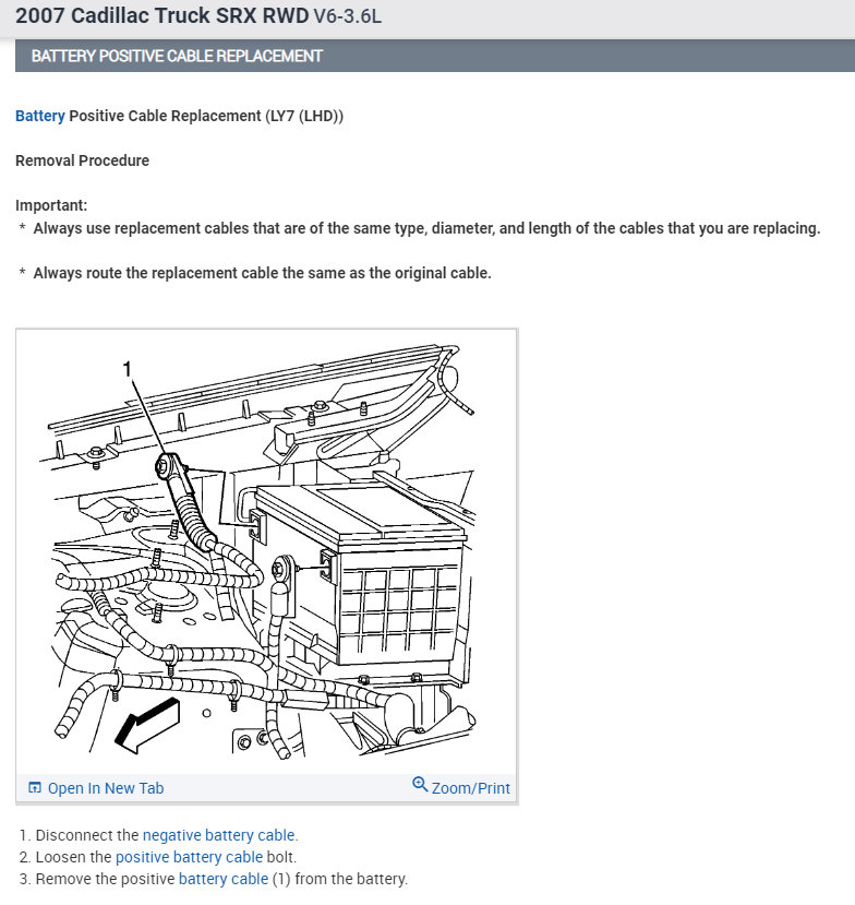

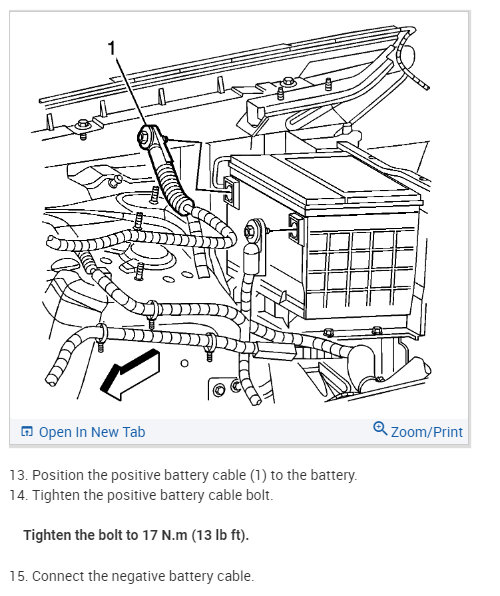

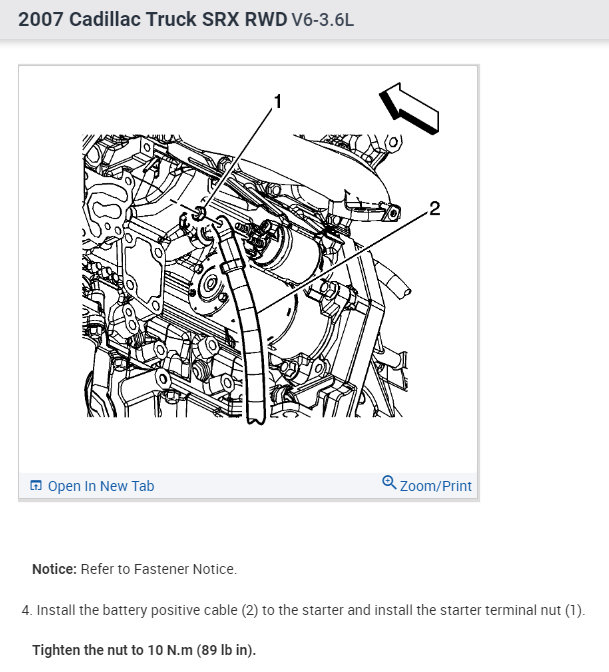

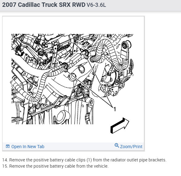

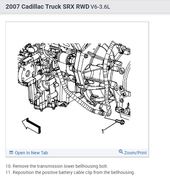

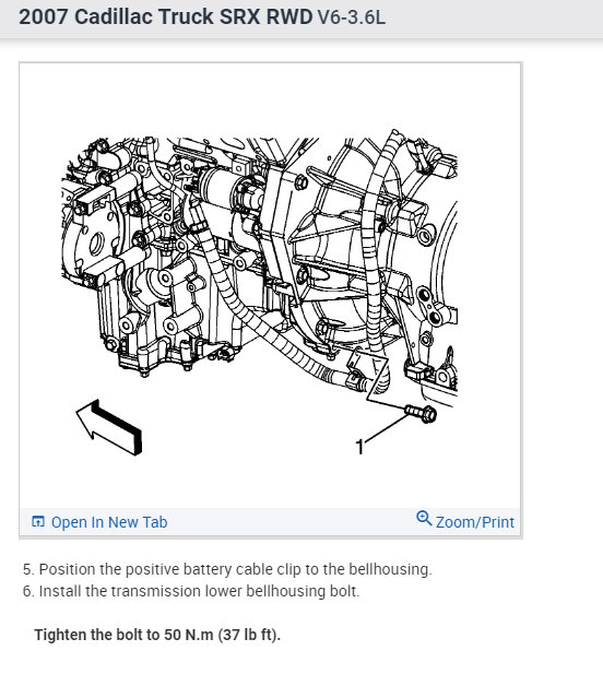

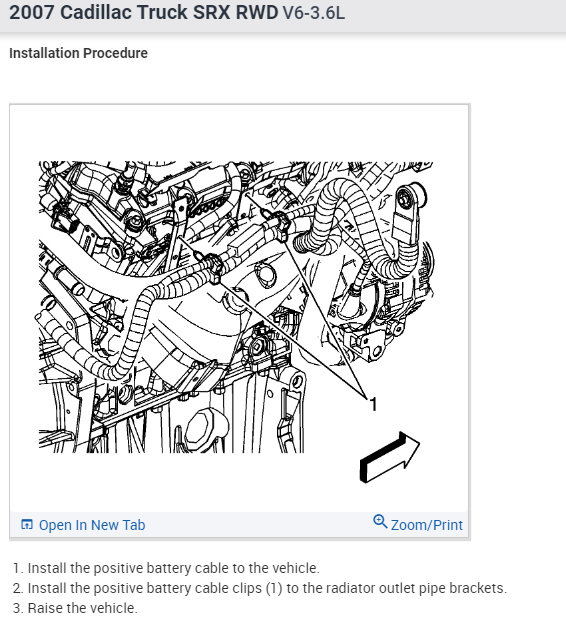

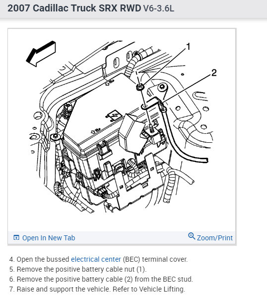

I want to change my entire positive assembly down to starter, it is defective. I am having trouble locating the starter.
Monday, July 25th, 2022 AT 9:11 AM
3 Replies
SQM
MECHANIC
6,383 POSTS
I have attached the replacement procedure for the positive cable below.
Let me know of any questions.
