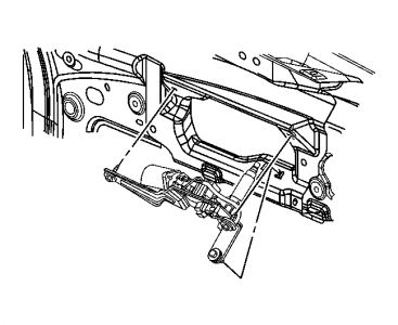

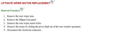

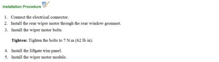

Where is the rear wiper motor located for my 2007 Pontiac Torrent. My local Pontiac dealer told me the motor needs to be replaced.
