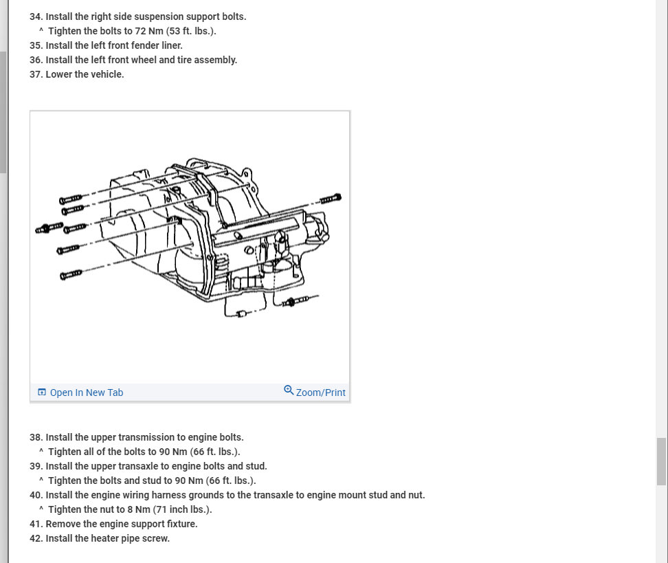

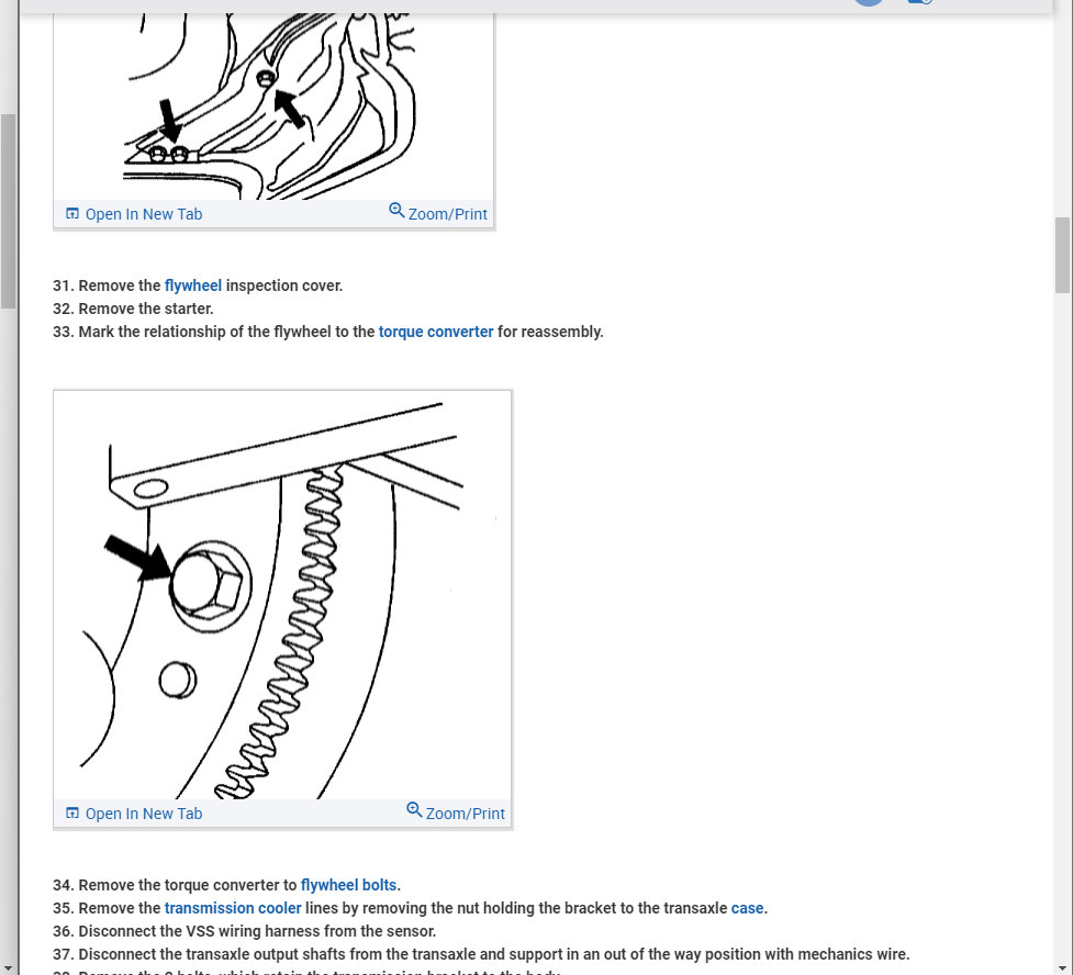

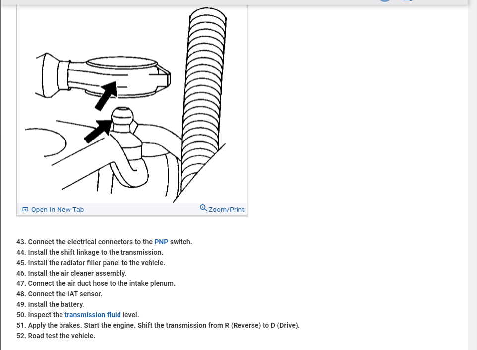

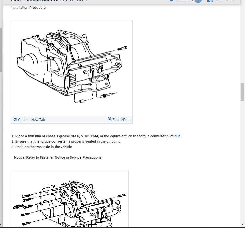

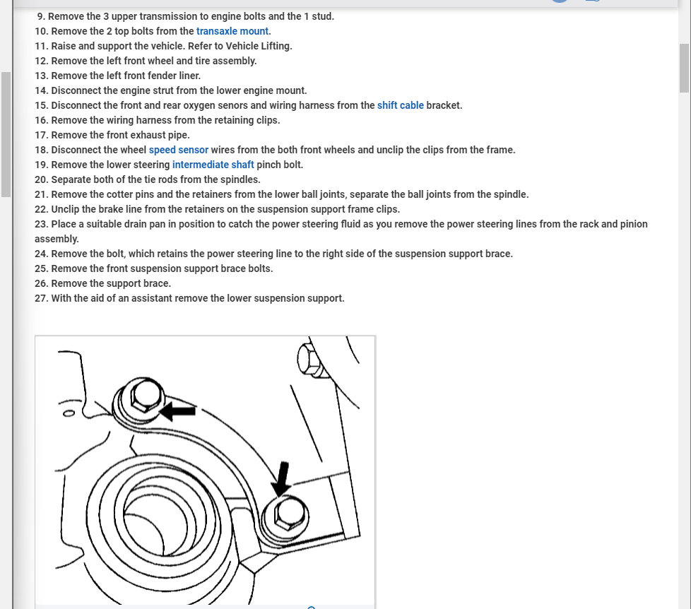

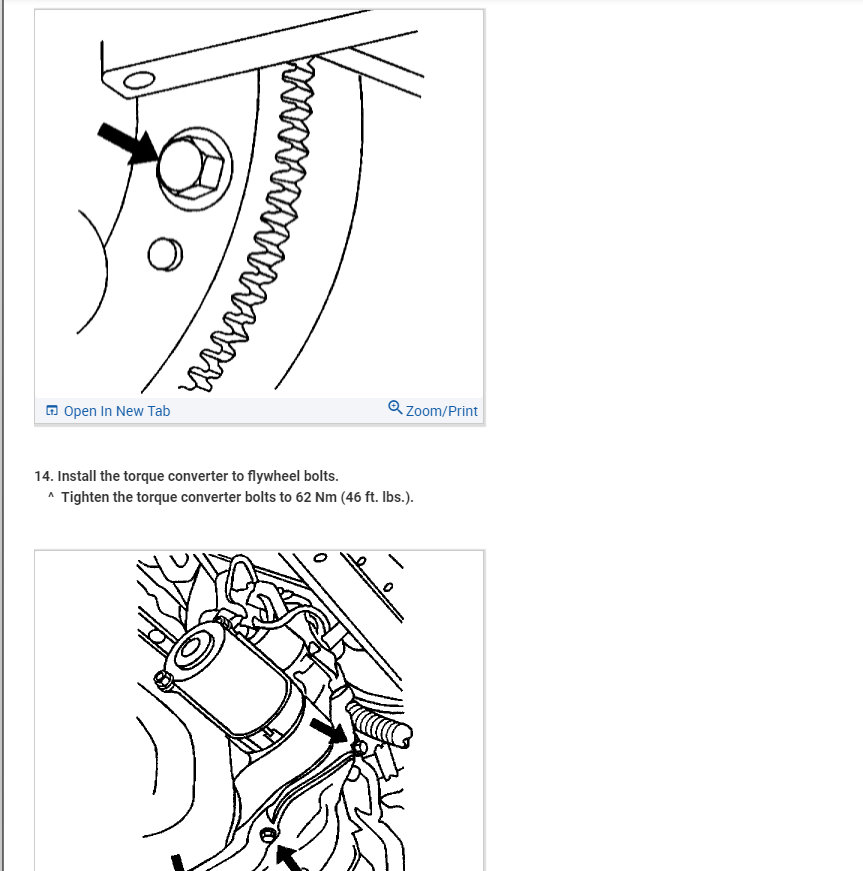

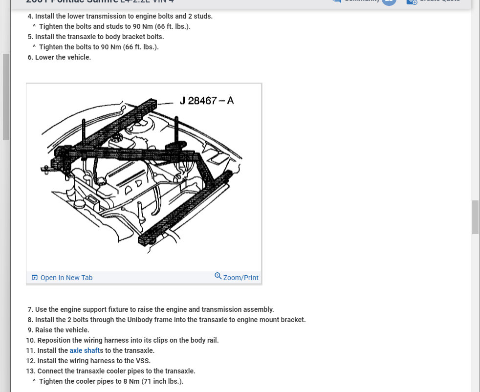

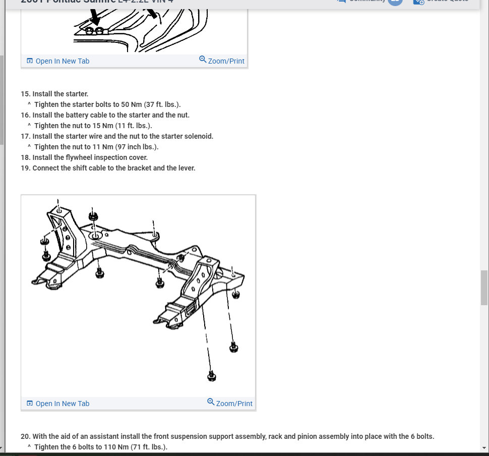

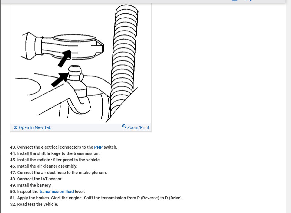

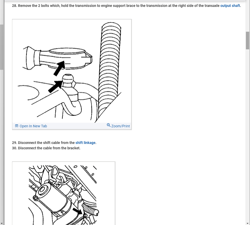

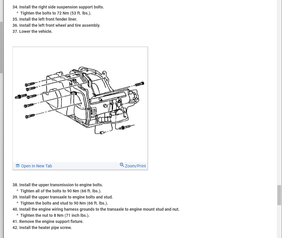

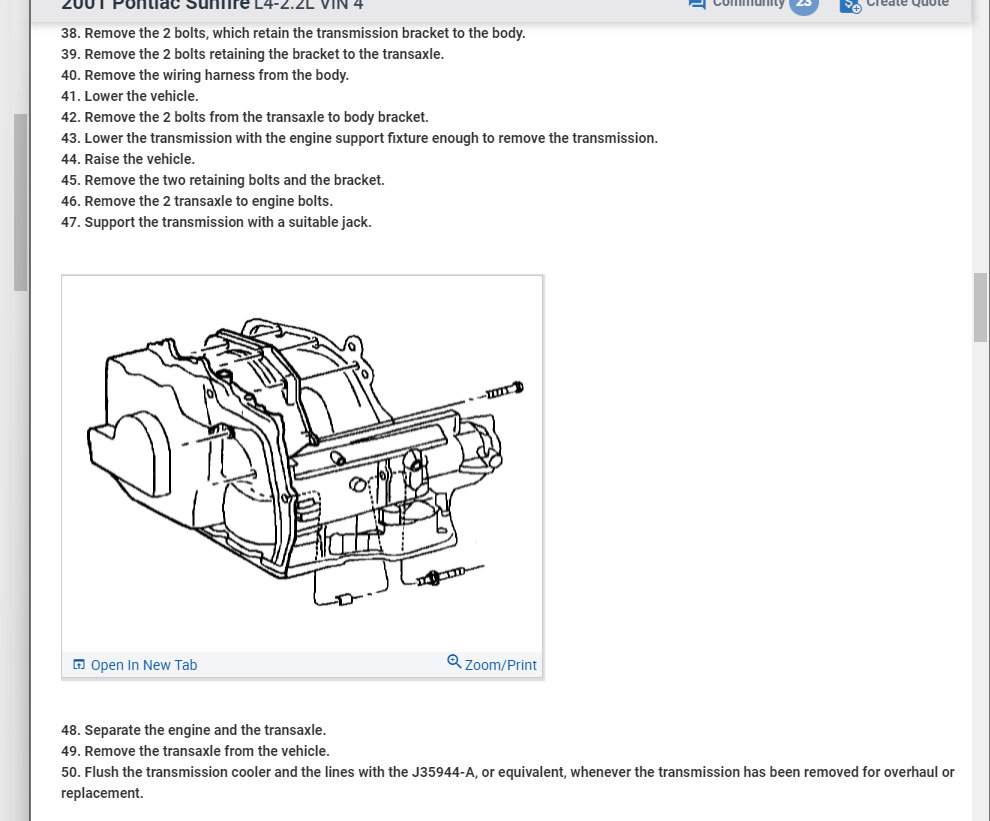

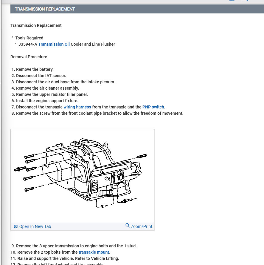

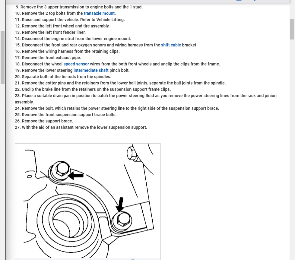

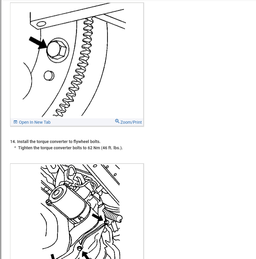

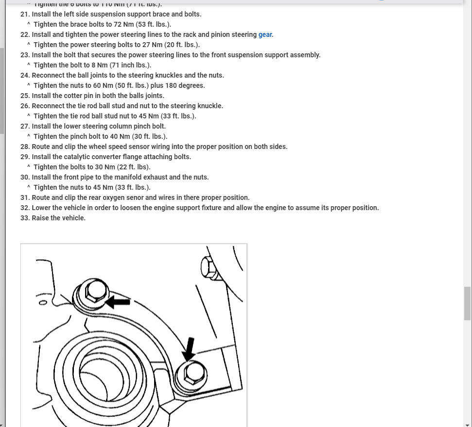

I need transmission replacement instructions including Illustrations on 2001 Pontiac sun fire. Thank you
Oct 15, 2009 at 12:31 PM
I will attach the process from the manual below on how to replace it but here is a video that will help with some general info that can be applied to any vehicle.
https://youtu.be/3vJAojsrfuU
The process is going to be about the same, but I am attaching the process for the 4 speed as that is more common.
Please run through this info and let us know what you find.
