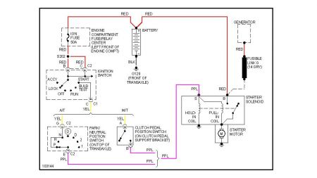

My starter in my car is dead, how can I use a relay switch to start it anyways

Turn key to run get a screwdriver go underneath and touch the battery terminal and the small terminal that has the purple wire.
Study the circuit below there's other ways on doing it
