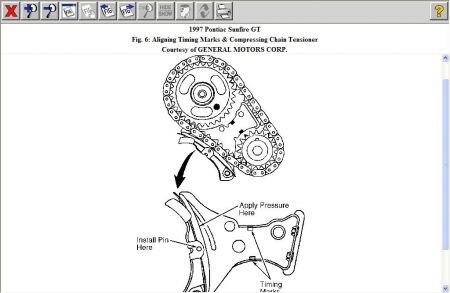

I dont know how to set the cam gear.
Saturday, March 8th, 2008 AT 3:40 PM
MECHANIC
75,992 POSTS
Put no.1 cylinder on its compression stroke/TDC and align markings as indicated below
