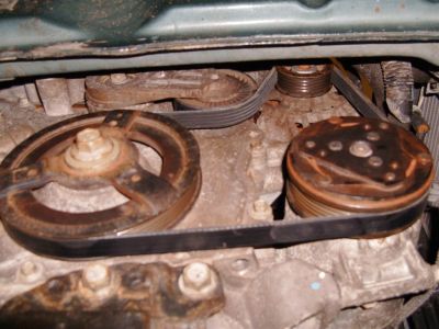

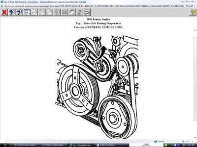

Need diagram for routing serpentine belt
Saturday, February 2nd, 2008 AT 6:10 AM
MERLIN2021
MECHANIC
17,250 POSTS
When replacing the serpentine belt on these 2.2 EcoTec’s it is easiest to remove the right front wheel and inner splash shields to gain access to the tensioner.
