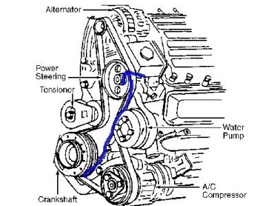

Can you replace the belt without the air conditioning compressor pulley since air conditioning is optional on the car?

If this is what yours looks like, then I would say no, as the water pump would not be able to turn.
