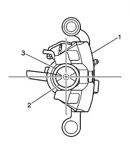

Unable to re tract ysed c clamp opened bleeder will not move?

Piston needs to rotatedclockwise special tool needed. Parts house should have.
