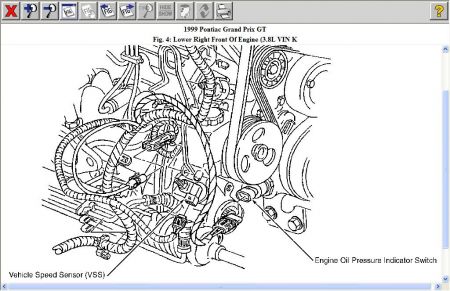

where is the speedo sensor located on the transmission? And how do I get to it from under the hood or underneath the car?

Its on the lower right side of engine compartment on transaxle-go underneath-see below
