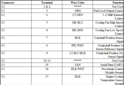

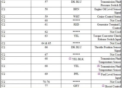

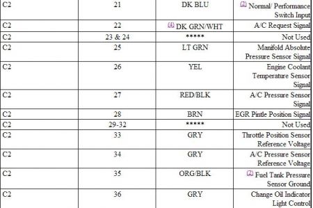

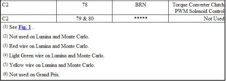

PCM Pin Out Diagram
RAMONE2005
  • 1998 PONTIAC GRAND PRIX
  • 6 CYL
  • FWD
  • 29,000 MILES

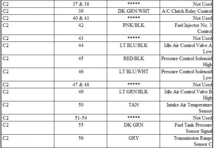

Hi I wonder if you can help,
I am desperately trying to get an ecu pin out diagram for the above vehicle, The vehicle has been completely rewired, but we can no work out this part. If you can point me in the right direction that would be wonderful.
Tuesday, August 18th, 2009 AT 12:02 PM
BLUELIGHTNIN6
  • 16,542 POSTS

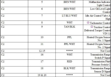

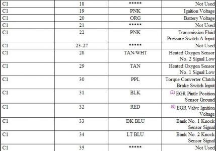

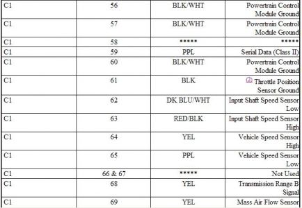

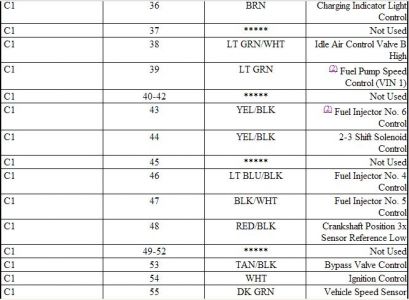

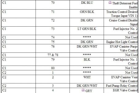

https://www.2carpros.com/forum/automotive_pictures/261618_Graphic_115.jpg
https://www.2carpros.com/forum/automotive_pictures/261618_Noname_843.jpg
https://www.2carpros.com/forum/automotive_pictures/261618_Noname2_219.jpg
https://www.2carpros.com/forum/automotive_pictures/261618_Noname3_77.jpg
https://www.2carpros.com/forum/automotive_pictures/261618_Noname4_44.jpg
https://www.2carpros.com/forum/automotive_pictures/261618_Noname5_21.jpg
https://www.2carpros.com/forum/automotive_pictures/261618_Noname6_13.jpg
https://www.2carpros.com/forum/automotive_pictures/261618_Noname7_5.jpg
https://www.2carpros.com/forum/automotive_pictures/261618_Noname8_3.jpg
https://www.2carpros.com/forum/automotive_pictures/261618_Noname9_1.jpg
https://www.2carpros.com/forum/automotive_pictures/261618_Noname10_1.jpg
