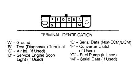

How do get the fault codes on a 1993 Pontiac Grand Prix without a code reader?

Use a paper clip or a wire and junp connect terminal A& B
Turn ignition on check engine light should flash out the codes
https://www.2carpros.com/forum/automotive_pictures/99387_Graphic1_709.jpg
Grounding the ALDL test terminal "B" at this time should cause SERVICE ENGINE SOON light to flash a Code 12, followed by any codes stored in ECM memory.
