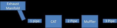

It definitely was not the manifold directly connected to the engine. It was glowing hot right underneath the driver/passenger area of the exhaust. There is a enlarged part of the exhaust at this location is this the catylitic convertor? I am not 100% sure what this convertor looks like. It was where the exhaust system actually bolts together. Also when the car is started now the whole exhaust system vibrates very bad. There is no alarm system on the vehicle.

Okay. . .. . ...it wasn't the exhaust manifold. . .. . .. . .. . ...that connects to a pipe that goes into the catalytic converter. . .. . .. . .then there is a pipe from the converter to the muffler, then from the muffler out the tail. . .. . .. . ..
In the pic below what was red?
https://www.2carpros.com/forum/automotive_pictures/248015_Exhaust_1.jpg
Was there a rotten egg smell or any color smoke out the tail?

It would have been pipe 1 and the catylitic convertor glowing red hot.

Well, you can either take it to a muffler shop to check to see if the cat collapsed or disconnect the exhaust where it connects to the exhaust manifold and move it out of the way a little and fire it up.
If it fires right up. . .. . .. . .your cat is plugged.
Now the thing that concerns me though is the code you got. . .. . ...if it is running to lean the that can damage your cat. . .. . .. . .. . .so the lean problem will have to be fixed.

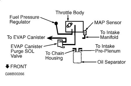

Check the Evaporation canister to see if it is saturated with fuel. . .. . .
https://www.2carpros.com/forum/automotive_pictures/248015_FIG_10_1.jpg
Other things that can cause the vehicle to run rich is your engine coolant sensor, MAP and IAT sensor.
With it getting that hot please really check over your O2 sensor for damage. . .. . ...that would also cause it to run rich but it should have thrown a code.
