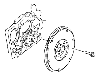

What is the toqrue on the flywhell bolts to the crankshaft on a 2000 pontiac grand am 2.4 engine

1. Install new bolts or apply adhesive/sealant compound GM P/N 123454493 or equivalent to the bolts which you are reusing.
2. Carefully follow the instructions included with the thread locking compound in order to ensure proper bolt retention.
3. Install the flywheel and the attaching bolts.
4. While holding the crankshaft balancer with J 38122-A, tighten the bolts evenly to 30 Nm (22 ft. lbs.), + 45 degrees using J 36660-A.
