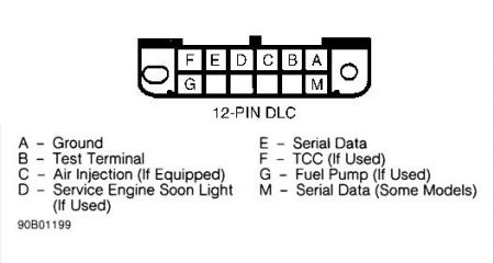

The check eng light comes on they tell me I need a ob11 but the plug is a obd1. Codes donot display at all and now the car is hard to start and chugs when you go down the road

Welcome to the forum, if your fully obd 1 compliant, you should be able to get mil codes. Use jumper wire between A & B terminals of datalink connector, turn key on, no crank, the mil starts flashing, you count the flashes to get the codes. your looking for two digit codes.
How long since a tune-up?
https://www.2carpros.com/forum/automotive_pictures/170934_95_grand_am_1.jpg
