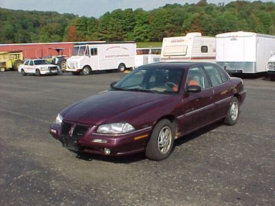

FIRST:The check engine light comes on after about 10 miles..
Then the remote starter: quit working... next day..
Then the turn signals: Work VERY slowly. Blinking every 5 seconds or so.....
Then the ABS light came on....
Then the battery light comes on; then goes out...

Sounds like you are having a charging problem.
(The ABS computer will freak out if the voltage gets too low.)
Pull the engine codes and get back to us.
