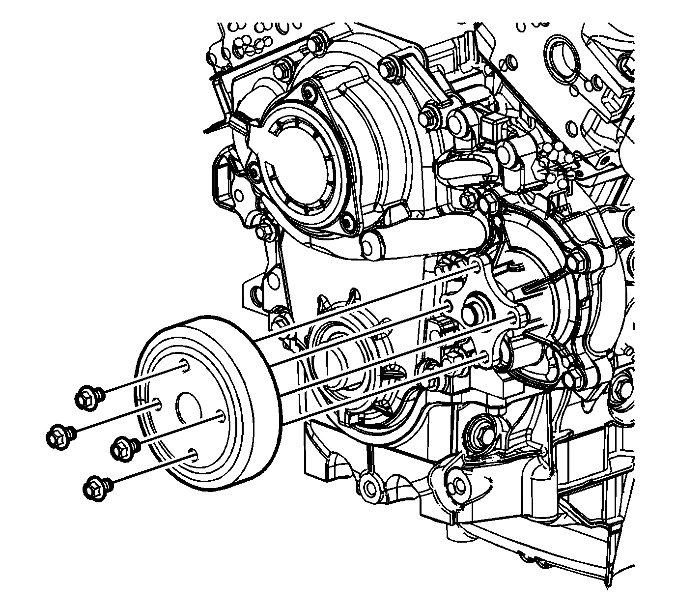

How do I replace the water pump? 3.5 engine

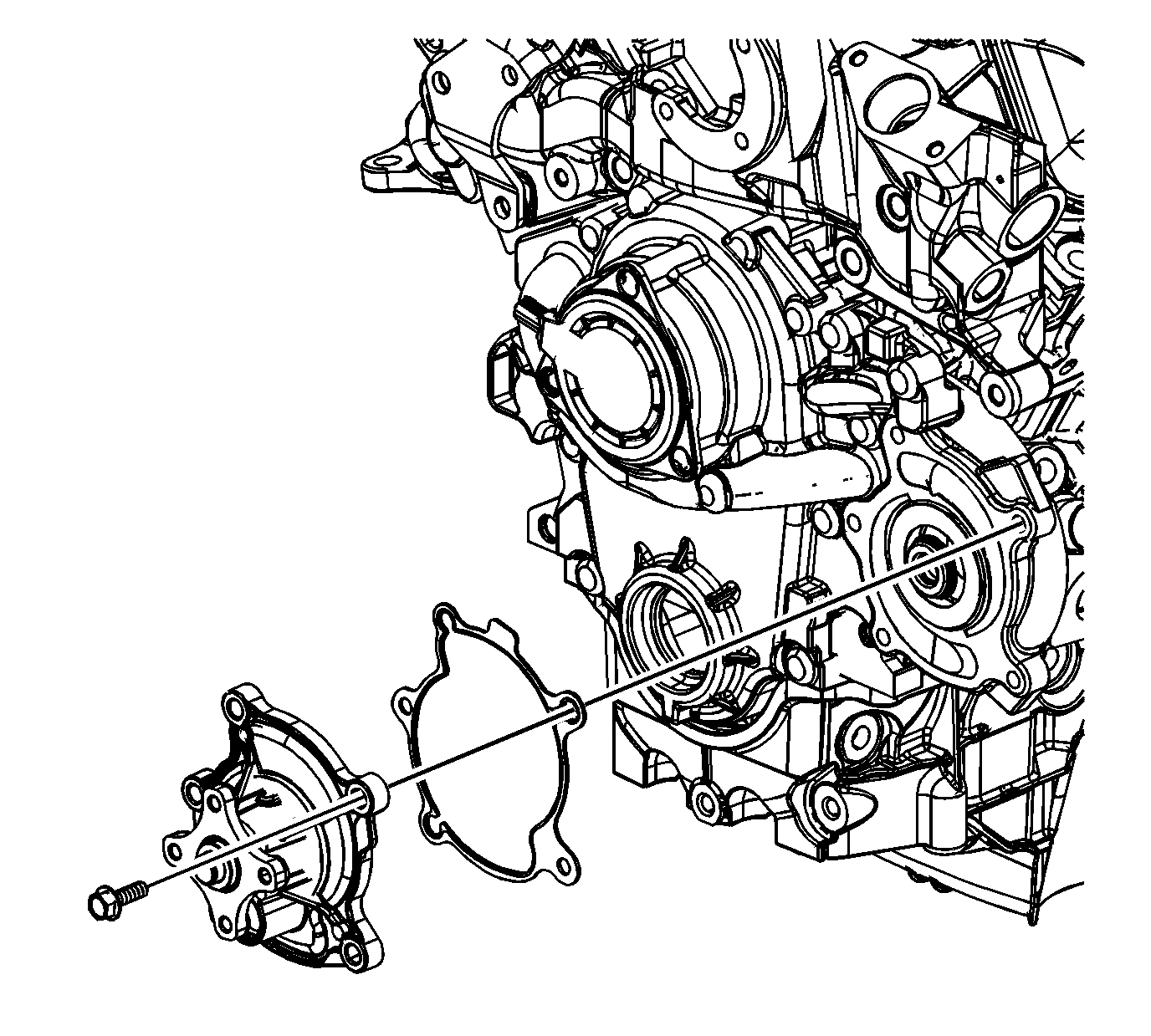

This is a straight forward job. Here are the directions. It is broken into removal and then replacement. The attached pics correlate with the directions.
_______________________________
2007 Pontiac G6 V6-3.5L
18. Water Pump Removal
Vehicle Engine, Cooling and Exhaust Engine Service and Repair Overhaul Unit Repair 07 G6 3.5L Repair Instructions 18. Water Pump Removal
18. WATER PUMP REMOVAL
Water Pump Removal
pic 1
1. Remove the water pump pulley bolts.
2. Remove the water pump pulley.
Pic 2
3. Remove the water pump bolts.
4. Remove the water pump.
5. Remove the water pump gasket.
