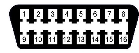

1997 Pontiac Firebird, 3.8 v6, fully loaded with power options. Last week i was driving and from out of nowhere, the engine cut out instantly. I coasted off to the side of the road and tried to restart, but when i turn the key forward, nothing on the dash lights up and the starter will not engage. The headlights and horn still work, but there is no power when the key is turned on. I replaced the ignition switch under the dash(which is not an easy job). Since then I have checked all the fuses under the hood and inside the car, none are blown. The ODB tester wont even light up when plugged in to give me a code because there is no power going to the harness. Could there be an inline fuse somewhere that I dont know about? Or could it be the starter? I would think that even if the starter was bad, power should still flow and light up the dash when the key is turned forward. Being a full time college student, I dont really have the money to take the car to a dealer to have the problem fixed. Ive been fixing junk cars ever since i started driving, so I feel confident that if I know what is wrong, I can repair it. I just cant figure out what the problem with this car could be, Im stumped. Any help would be greatly appreciated. Thank you very much.

Hello, As far as the scanner, I'd check that pin 16 at the datalink connector has voltage, should be hot all the time. If no voltage check the cigar fuse, check the fuse circuit is hot. There is a theft system that could effect starter. I wouldn't think that would effect your dash? Did you try a different key? I might have to check feed to and from the ignition switch.

Ok, i checked the #16 pin, no voltage there. I pulled the fuse for the cigar lighter and it was fine, but no voltage there either when i probed it with the test light. Unfortunately I only have 1 key for the ignition, and yes it does have the chip in it. Maybe the chip in the key somehow went bad? The headlights, horn, and 4 way flashers still work, and i checked the battery, it has more than enough power. Could it be possible that the wire going to the starter is bad, not allowing power to flow through the circuit, therefore not getting power to the ignition switch when the key is turned forward?

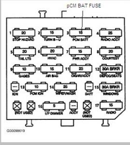

Sep 9, 2009 at 5:09 PM
JDL
  • 16,098 POSTS
https://images.2carpros.com/forum/automotive_pictures/170934_pontiac_firebird_pcm_fuse_1.jpg
Is that the fuse your looking for, I/P fuse block. Also, at the cigar fuse, make sure neither leg is hot, pull the fuse. Check for continuity between the terminal for the right fuse leg and terminal 16 on the datalink connector. Do an ohms test, if continuity is good, use a jumper wire connected to battery voltage to the right fuse terminal, use inline fuse on the jumper. Then, pin 16 at the data link conector should be hot, maybe you can check codes?? As far as data bases, the best info are premium sites, It'll cost you. Large libraries carry automotive databases, If you live in a county they serve, I believe the info is free. With any testing I tell you about, if you get something hooked-up wrong, that is your responsibility.
Sep 10, 2009 at 10:03 AM
OSRCLINT74
  • 13 POSTS
Where exactly is the fuse panel that you provided the diagram of? I am looking at the cover for the fuse panel that is inside the drivers side door right now, and it has some of the same fuses, but there is no pcm battery fuse listed on mine, or pcm ignition fuse. In place of those 2 fuses is STG WHL CNTRL 1 amp fuse in each slot. The car has the radio controls on the wheel, so I'm guessing that's what those fuses comtrol? The diagram you provided must be for a car without the steering wheel controls. Is there possibly another fuse block other than the one inside the door and the one under the hood, and if so, any idea where it might be located?
