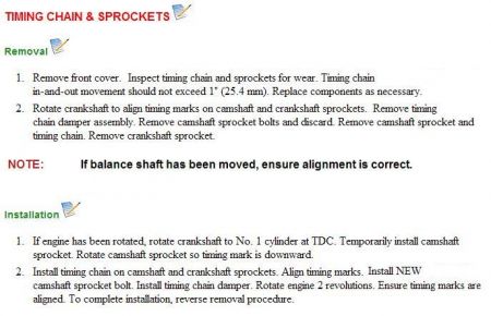

How do you replace a timing belt for a 1997 Pontiac Firebird 6 cylinder?

Your vehicle is equipped with a timing chain, not a belt. Replacement procedures are below...

Does the motor have to come out?
