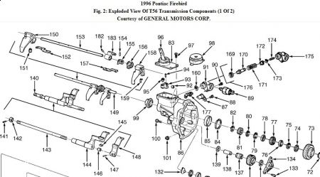

From the additonal info, I believe the problem is more likely to be from the shifter area.
Check if there are any foreign materials preventing the shift from moving in that direction.
Here is an exploded view of the shift section.
https://www.2carpros.com/forum/automotive_pictures/192750_TransShift96Firebird01a_1.jpg
Remove items 83 and 96 with gear shift in neutral and and test if you can manually engage the gears.
Check related areas of Items 149 and 153.

I checked and there doesn't seem to be anything in the way. With the shifter off I still wasn't able to shift into 3rd. It gets halfway there and won't go any further and when I let go, it pops back into neutral.

During removal/installation of the trans, something could have got stuck, might be the synchro gears. Have you started and moved the vehicle around?
If it is the ring gears that are stuck, it might come loose after some movement. If it is a detent bearing or stopper type ball bearings, some force might be required to release it if it is stuck.
Sunday, July 5th, 2009 AT 7:06 AM

Of course not too much force should be used. Try jerking the gear lever with about 20 lbs of force. The parts are robust and would not give way easily and from what you have desctribed, it should be from the shifter area.
To rectify the problem, the portion would have to be disassembled to check the shifting rods and detent bearings position and wear.
