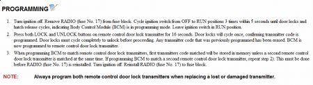

How do you program a keylessentry remote for a 1996 firebird
Thursday, December 31st, 2009 AT 12:53 PM
OBXAUTOMEDIC
MECHANIC
3,711 POSTS
Here it is....
