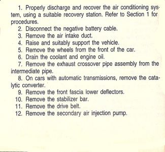

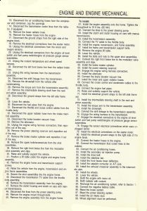

I wondered about the engine removal and found that one must remove the engine from the bottom . Before 1993 the engine could be removed from the top like normal bujt since the body style change it's diferent. What bothers me about your engine is that the oil pressure stays up until it reaches 180 degrees. If you lost oil pressure the lifers would make a racket. you can try using some engine cleaner. the screen in the oil pan could be glogged. Or it could be the oil pump. try some engine cleaner first to see what happens. enclosing instruction to remove the engine. You might have to save as picture then resize when you have them on your computer.

before going through all that try some engine cleaner to see if the screen is clogged. It will help clean it a bit. Also see if you can get a mechanical guage for the oil pressure. This way you would know for sure its not the electrical guage or a bad wire connection. and it will save a lot of money if the guage or wire is bad. If you find little or no oil pressure then you can still pull the engine.
