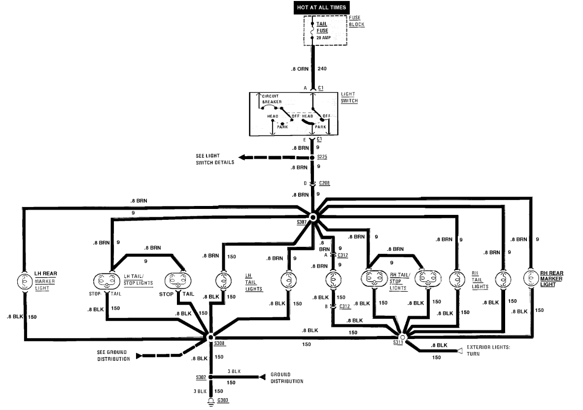

I recently replaced the ignition lock cylinder on my car listed above formula. After the work was completed, my right blinker would stay on solid (w/o blinking) I then replaced the blinker switch inside the steering wheel. This did not solve the problem and furthered it by making both blinkers stay on solid and there were no taillights or brake lights when the brake pedal is depressed. There is also a loud buzzing sound when the brake pedal is pressed without the car running. Any help would be appreciated.

This sounds likes a bad ground which is usually at the rear blinkers. Here is a guide to help and the blinker wiring diagrams so you can see how the system works and where the grounds are:
https://www.2carpros.com/articles/turn-signals-not-working-blinker
This guide can help you check for power and grounds:
