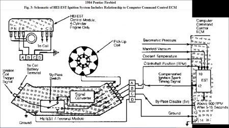

Hi
Need to know which is the connector B, R or E. That we can use for the signal out of an after market ECU (Microtech)
The Microtech has one output to switch the distributer on & off.
Regards
Paul

Hello -
Is this what you are looking for?
On all models with full function systems--except V6-229 (1982 VIN code K and 1983-84 VIN code 9) engines--the ``R'' terminal on the 7 pin ignition module provides reference pulses to the ECM indicating engine RPM and crankshaft position.
Pic also attached.
