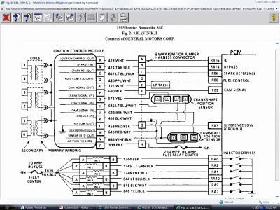

Can someone tell me which wire going into the coil pack (3 coils together) is considered the negative coil wire? There are 14 wires in the plug. I am trying to make a connection and one is 12V, 1V, some register -mV and others +mV on my multimeter. With a single coil, there used to be a positive and negative side. I need the "negative coil wire".

You didn't say but this is the 3.8 setup, and close up of the coils and ignition module.
https://images.2carpros.com/forum/automotive_pictures/62217_WDa_2.jpg
https://images.2carpros.com/forum/automotive_pictures/62217_WDb_2.jpg
Negative is tack wire

You said "Tack" is negative. Did you mean "Tach"? I see one labeled "I/P Tach" which is the white E wire in the 8 way harness. Please let me know. Thanks!

yes just a slip by my stubby fingers!!
