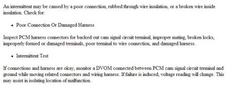

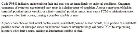

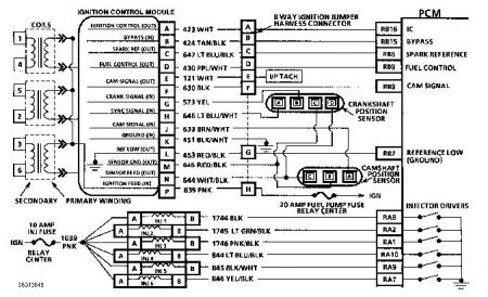

My car has p codes p0341 & p0342. These deal with cam sensor. Any ideas
Thursday, February 26th, 2009 AT 9:06 PM
