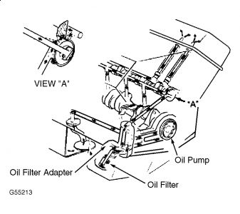

where is the oil pump on my car?
Monday, June 1st, 2009 AT 7:20 AM
MMPRINCE4000
MECHANIC
8,548 POSTS
Crankshaft driven.
Before changing oil pump, verify oil pressure with mechanical gauge, do not rely on oil pressure gauge.
