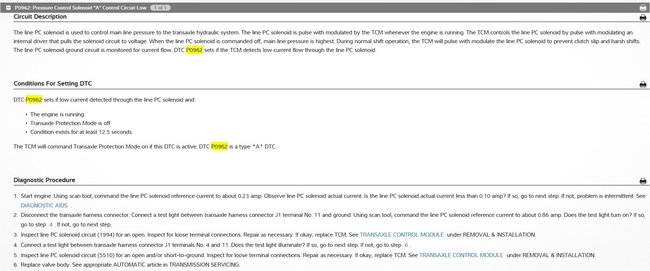

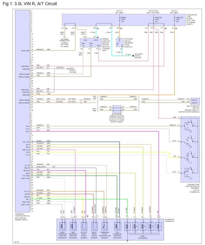

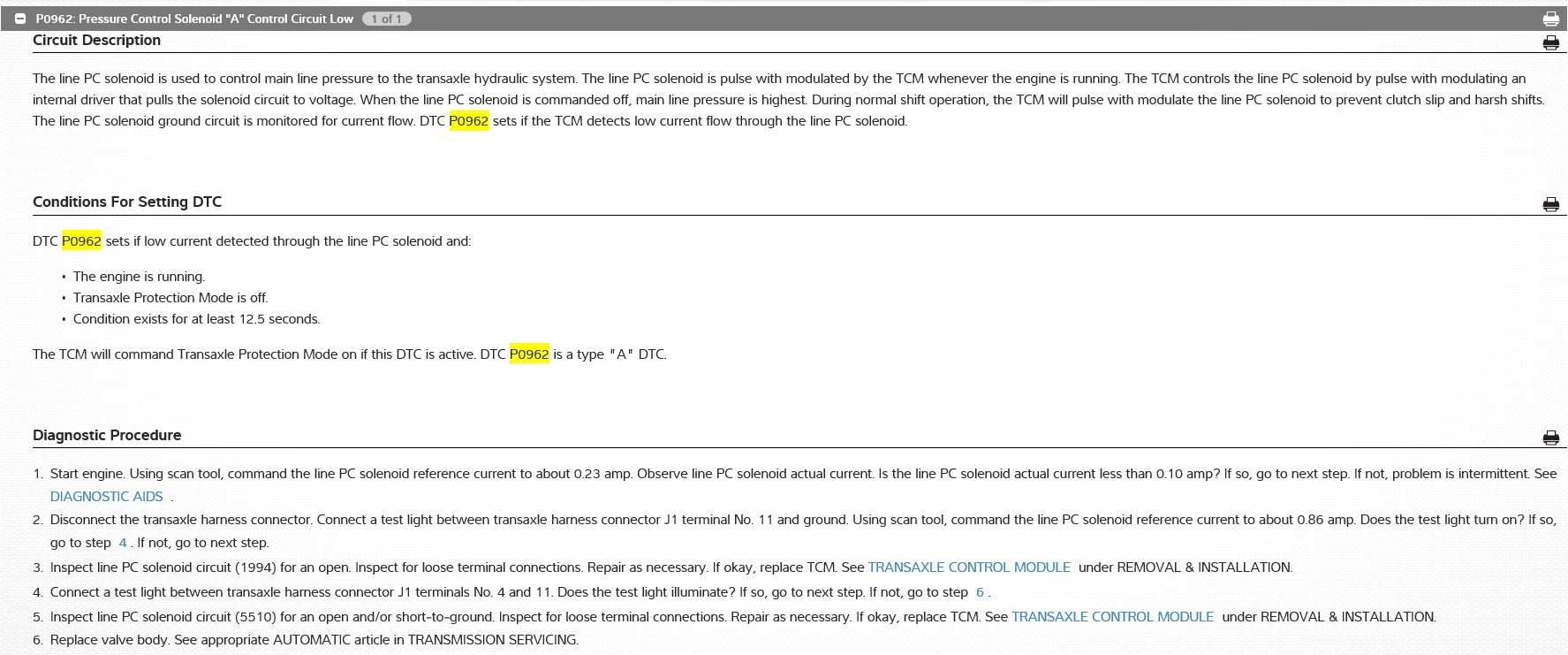

Hi! Just recently bought this vehicle and after driving between twenty five to thirty miles it started to have slow take off with high rpm's. Once rolling it shifts normal into the other gears. After some searching I finally figured out which transmission it has and found the dipstick. I let it warm up, went through all the gears and checked the fluid. It appeared to be at least a quart or more high past the full mark. I had the codes pulled and got PO700 and PO962. Is it possible the transmission being overfilled turned to foam and caused the problem setting the code or do I have more problems? I did drain some fluid and then had to top it back off to correct level. Haven’t taken it out on a long distance yet.
