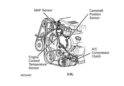

Where is the map sensor on a 1998 Plymouth Grand Voyager?

The location depends on the litre size of engine. The picture is for the 3.0

Its at the rear of the intake manifold if its 3.3 and 3.8 liter and 3.0 is at the front of the intake manifold
