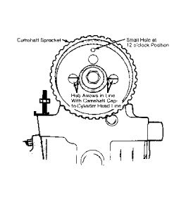

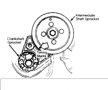

Need to know the possition of gears to reinstall belt
Sunday, January 13th, 2008 AT 7:32 AM
BMRFIXIT
MECHANIC
19,053 POSTS
This what i have hope that help
let me know
