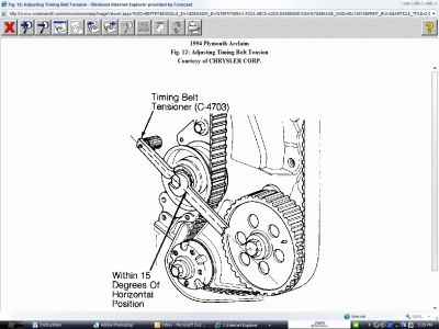

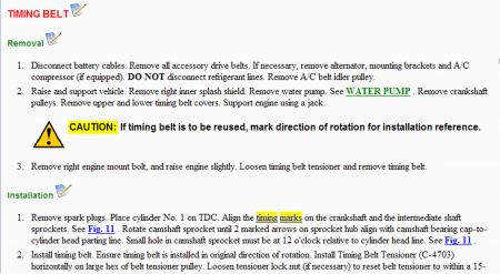

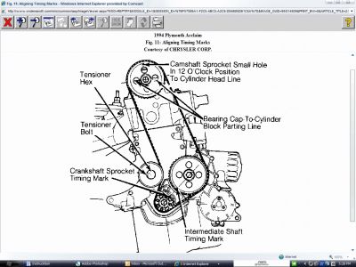

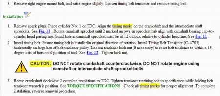

Looking for instructions on how to time a 2.5 liter dodge engine
Saturday, December 22nd, 2007 AT 4:08 PM
MERLIN2021
MECHANIC
17,250 POSTS
Here ya go...
