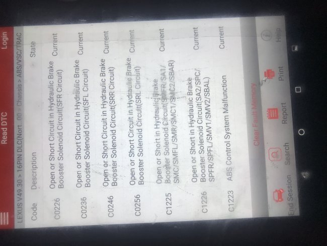

Could you please help? I am getting ABS and VSC on with codes C0226 and C0236 and C1223.

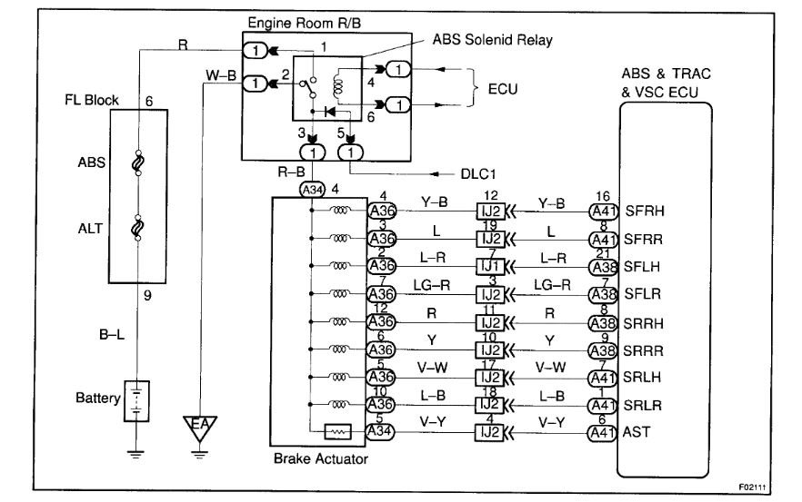

Good afternoon,

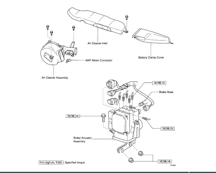

I will post the flow chart for you below with some diagrams. You will need to follow the flow charts to determine the failure.
The 1223 is related to the other two codes.

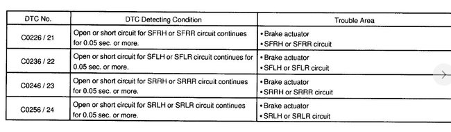

226 and 236

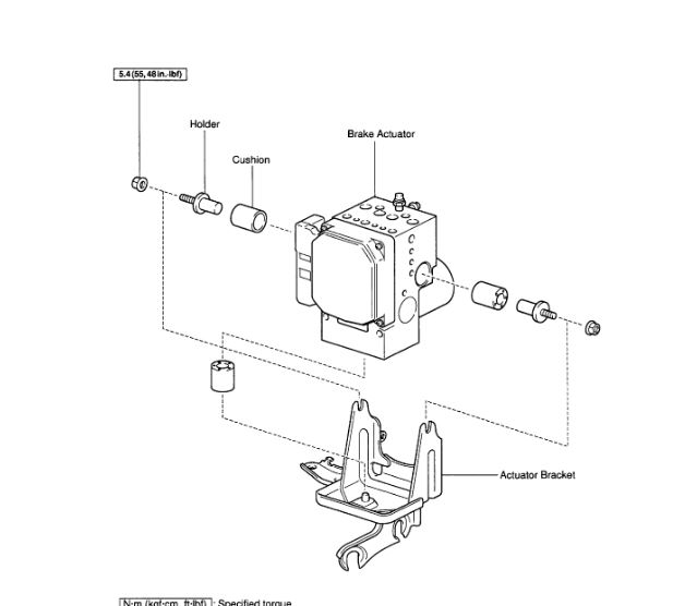

CIRCUIT DESCRIPTION
This solenoid goes on when signals are received from the ECU and controls the pressure acting on the wheel cylinders thus controlling the braking force.
ImageOpen In New TabZoom/Print
DETECTING CONDITIONS
Fail Safe Function:
If trouble occurs in the actuator solenoid circuit, the ECU cuts off current to the ABS solenoid relay and prohibits ABS & TRAC & VSC controls and the brake system becomes normal.

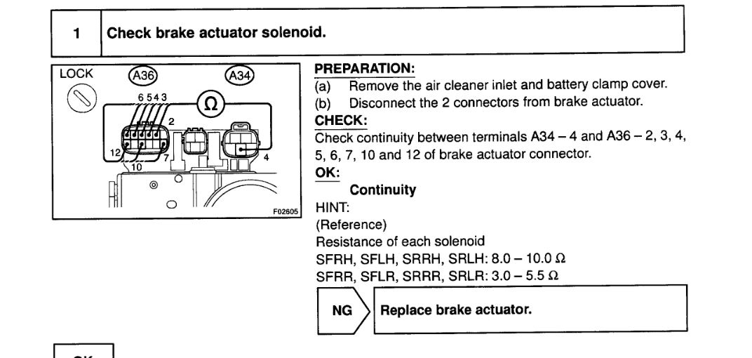

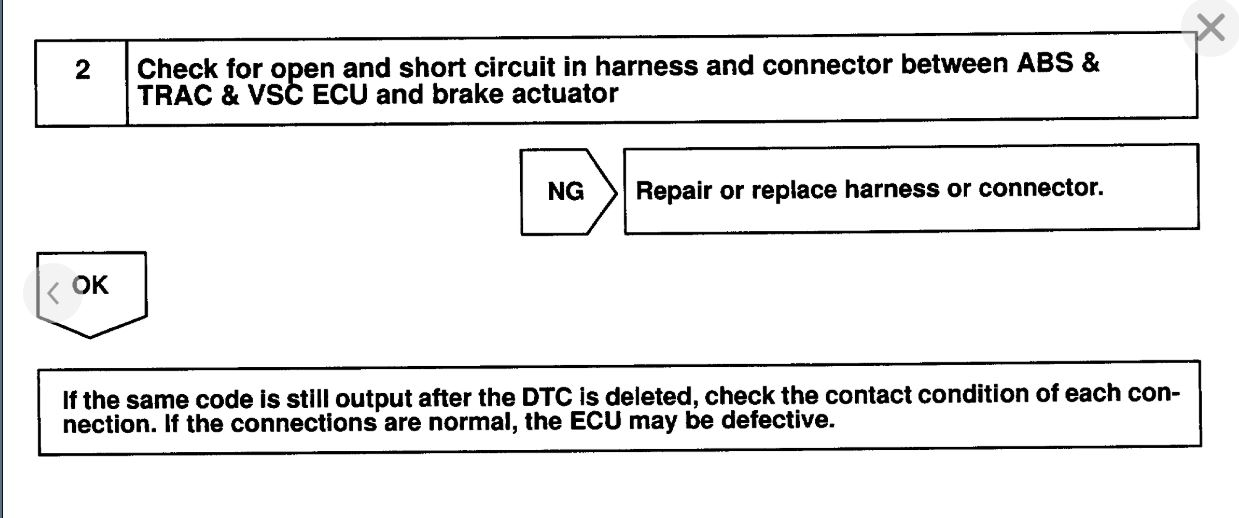

WIRING DIAGRAM
Step 1
Step 2
INSPECTION PROCEDURE

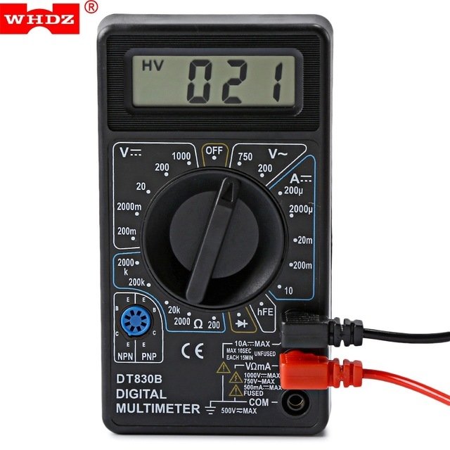

Most showing 7.6 and few showing no change only reading 1?
Friday, April 26th, 2019 AT 3:25 AM
Where are those readings? What did you use to see these readings?
Friday, April 26th, 2019 AT 3:50 AM
QEWANI
  • 32 POSTS
I have used the digital multimeter, setting the reading to 20k ohm where it shows 1 ohm on display and then checked the continuity by connecting one lead to A34-4 and the other lead to A36-2, 3, 4, 5, 6, 7, 10 and 12
i have noticed that all reading 7.6 ohm while some only show 1 ohm
i thought maybe the multimeter is damaged or mulfanctioning, but tested the multimeter while connecting both leads toghther where it was reading nearly zero, which indicate that the multimeter is working perfectly, should I go ahead and replace the brake actuator?
Saturday, April 27th, 2019 AT 3:47 AM
That's what it is pointing to.

I have check last time the reading from the ABS connectors instead of ABS itself. Just checked today again from ABS itself and continuity all showing zero. What next to check please?
Monday, June 3rd, 2019 AT 6:27 AM

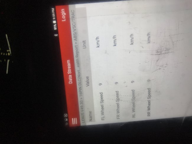

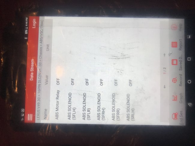

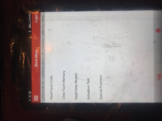

Can you read live data from the sensors while driving?
Monday, June 3rd, 2019 AT 5:24 PM
QEWANI
  • 32 POSTS

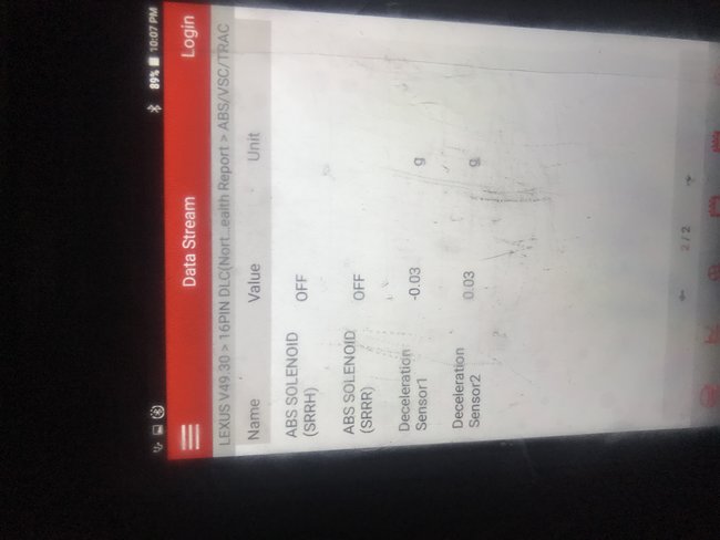

Tried to read live data but it seems it show the ABS sensor is off. See the photo and am getting some more ABS codes.
+1
Saturday, June 15th, 2019 AT 11:20 AM

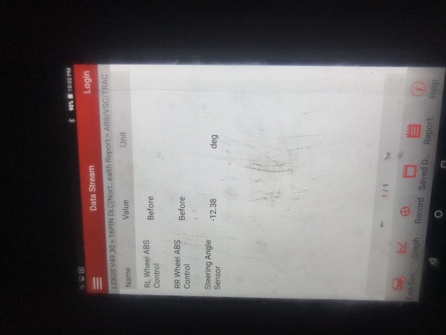

You need to view the ABS sensor readings. I do not see any option for the actual reading for the sensors. The information will be listed in MPH when you are moving.
Saturday, June 15th, 2019 AT 11:28 AM
QEWANI
  • 32 POSTS

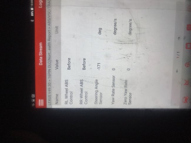

All speed sensor are seems to be okay. I am getting readings from all four sensors while moving.
Also steering angle sensor showing reading when turning the wheel left and right.
Yaw rate sensor also showing reading from start to stop.
Deceleration sensors also showing readings.
Am not not able to do calibration with TC with E1.
What to do next?
Tuesday, June 25th, 2019 AT 12:07 PM
Seem to be okay? Please explain.
Do they all read the same MPH when moving?
Tuesday, June 25th, 2019 AT 3:20 PM
QEWANI
  • 32 POSTS
Yes they all read the same.
Tuesday, June 25th, 2019 AT 6:26 PM
If they all read the same, the light should be off.
Is the light still on?
