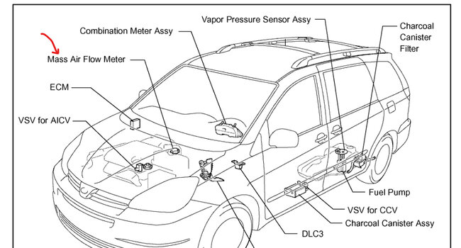

I would not install new injectors, the fact that the compression is only at 100 PSI means the engine is worn out, I would not do anything else except you can try a new MAF sensor which may correct the air fuel mixture. Here is the location in the diagrams below. Please let us know what happens.
