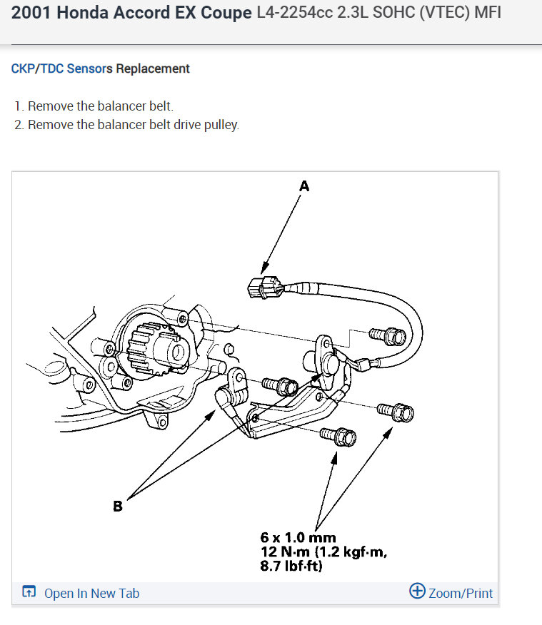

Hello, my check engine light came on while driving home from work today. The engine was running perfectly normal, both before and after the CE light came on, so there are no symptoms to mention, and the engine is running great. I got just one code, which is P1381.
What would be the most likely causes of this code for my make and model?
If you could point me in the most likely direction(s), that would be great! Thank you!

The P1381 code in your 2001 Honda Accord is related to the Cylinder Position Sensor which is location down at the crankshaft in the front of the engine behind the timing belt cover. Sometime the wiring can get messed up due to the timing belt coming apart. Check out the images (below). Let us know if you need anything else.

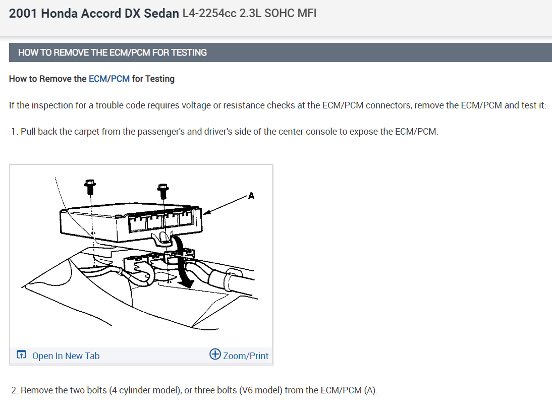

These readings are strange, could be because of the crankshaft sensor or you have a bad PCM.
RPM: 1951 - was the engine at a high idle?
VSS (mph): 50 - were you driving it at 50 MPH when you did the scan?
IAT (F): 122 - do you live in the hot desert?
If not, I would get a rebuilt PCM, you can get a preprogrammed unit by searching Google or Ebay.
Here is the location of the PCM. Check out the images (below). Let us know how it goes.
