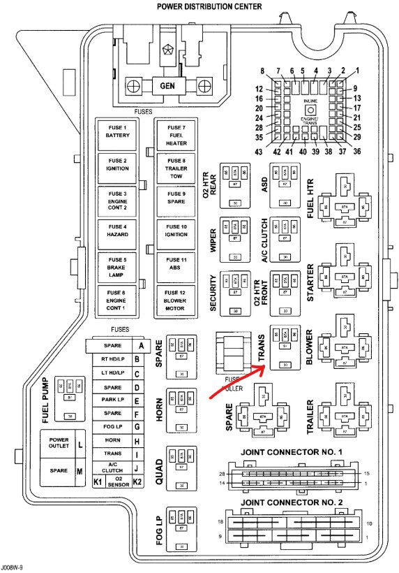

Yes, there is a transmission control relay I would swap out and then clear the codes, this relay controls the transmission and EVAP systems.
P0443 - EVAP Purge Solenoid Circuit
P0753 - 3-4 Shift Solenoid Circuit (Transmission)
P1765 - Trans 12 Volt Supply Relay Control Circuit
Here is the location of the relay and check the fuse#1 as well in the same fuse panel. Check out the images (below). Please let us know what happens.

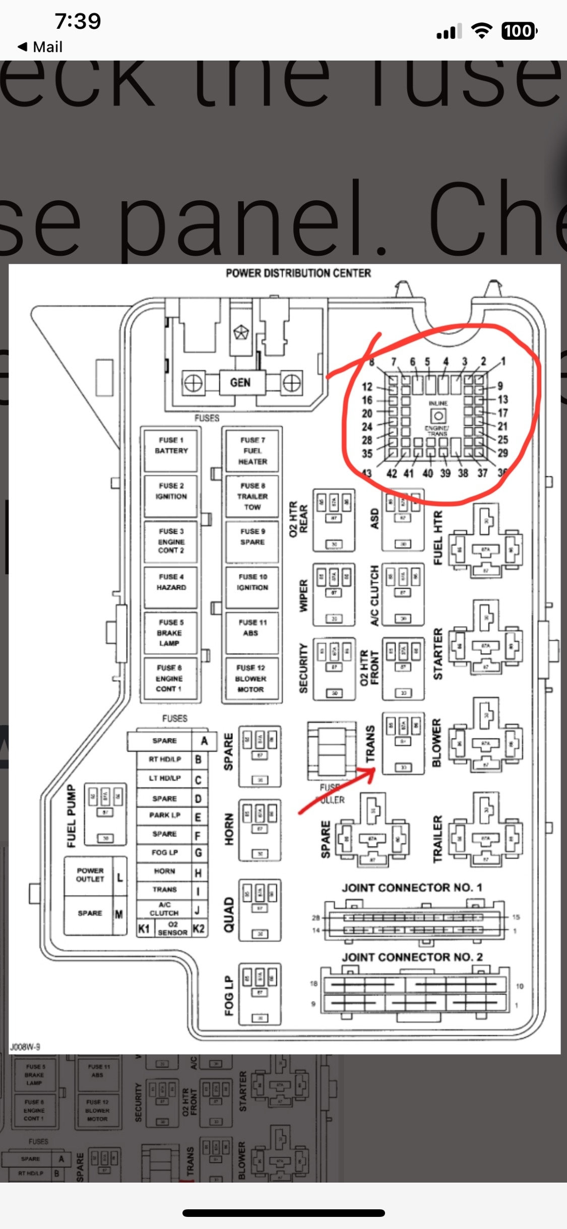

So, I just tested the relay and it’s good. Also, fuse #1 (labeled battery) is good.
I noticed the screw holding this big plug was loose, so I tightened it. Here’s a photo of what I’m talking about.
Thursday, May 15th, 2025 AT 8:13 AM
KEN L
  • MASTER CERTIFIED MECHANIC
  • 55,281 POSTS
Yep, that can do it, I would remove the connector completely to see if any of the connections are burned/corroded. Also, a relay can click but the contacts inside may not work, I would swap it out just in case. Let me know :)

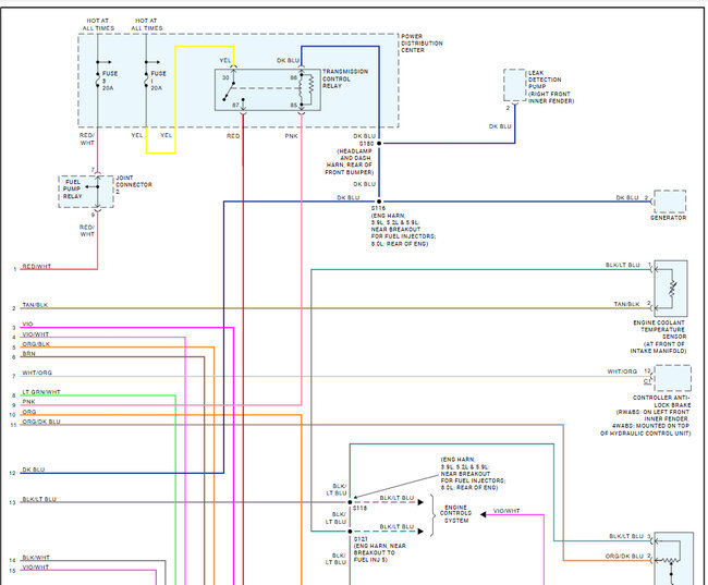

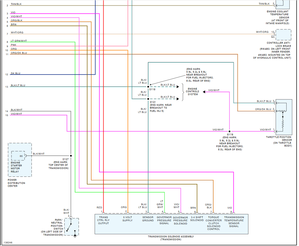

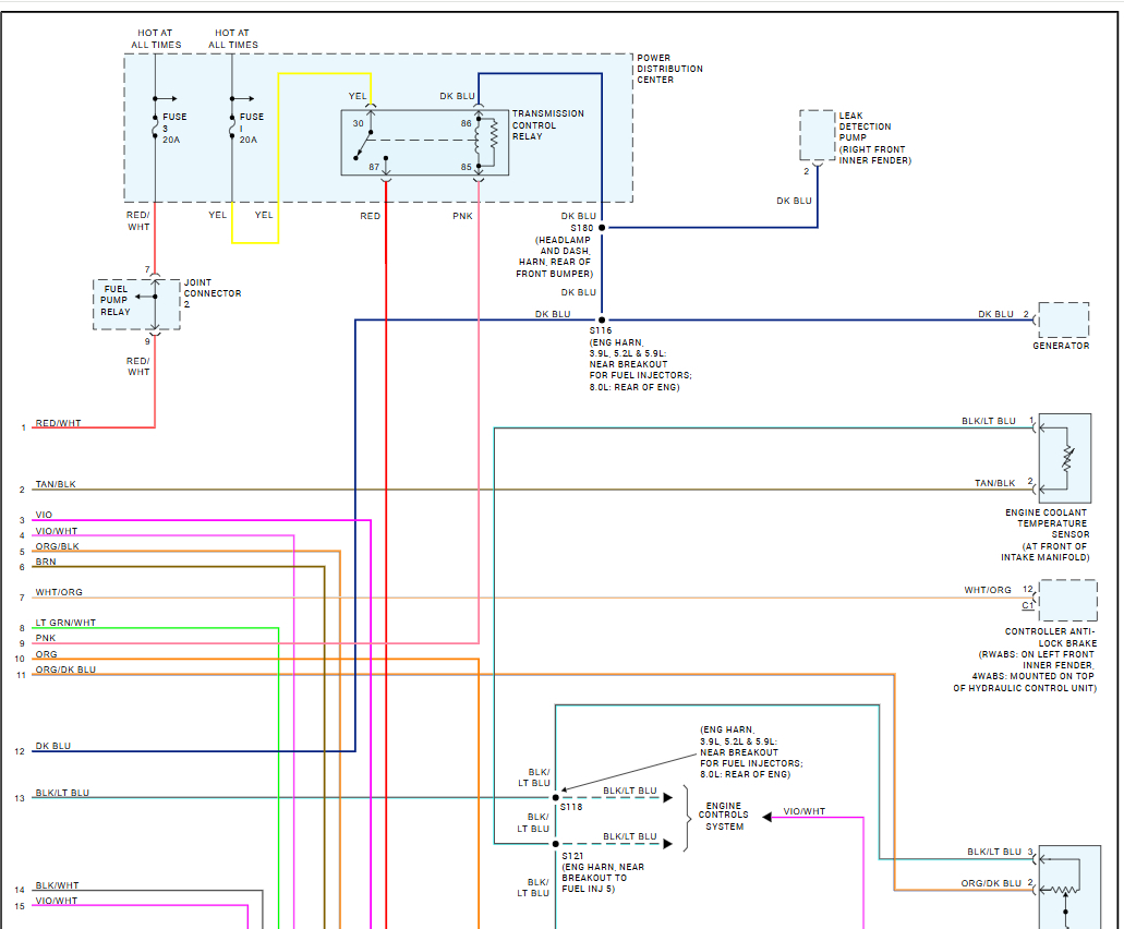

Yep, it is worth a try. Here is the wiring diagrams for the transmission relay, I would check to see if you get power at the red wire at the transmission solenoid assembly when the key is turned on.
This guide can help:
Check out the images (below). Let us know how it goes.

Hello Ken, had to sideline this project for a bit. Anyways, I’m not really good at diagnosing electrical stuff so I had a a buddy help me out. So, at the power distribution center, the trans control relay works. There’s power on the yellow (hot at all times). With key turned on, there’s no power on the red at the solenoid assy. (No damage to red wire). Now according to my buddy, at the PCM, a signal (ground) is sent via the pink wire to trans control relay which then completes the circuit sending power down to solenoid assy. There is no signal(ground) on that pink wire at key on or start up. Buddy suggested I splice into that pink wire and ground it directly to the body and if the transmission starts shifting normally then I have a bad PCM.
Should I or shouldn’t I?
Sunday, May 25th, 2025 AT 2:58 PM
KEN L
  • 55,281 POSTS
That sounds correct, the pink wire grounds and closes the relay, I would give it a try. Let me know.
