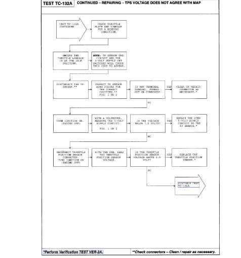

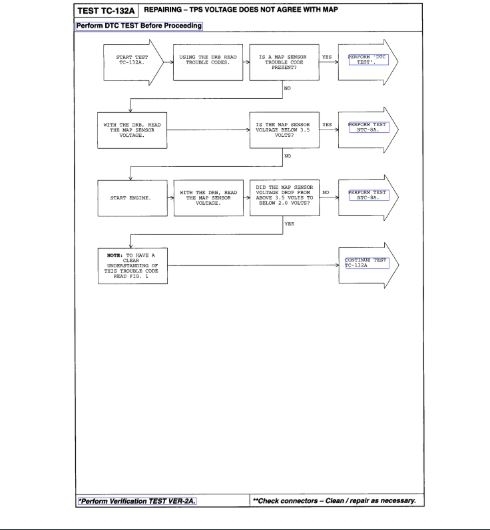

I keep getting a p0120 code. What is this and how to fix it?

P0121.

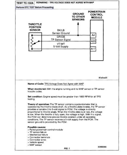

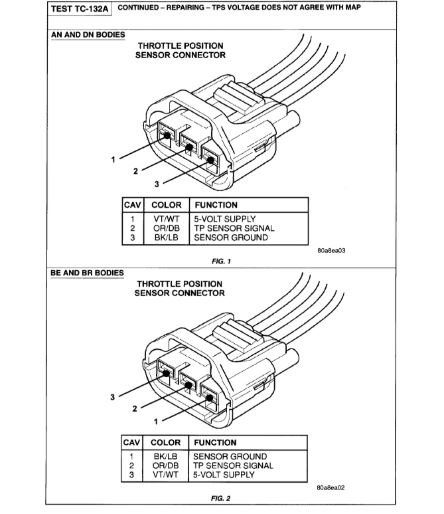

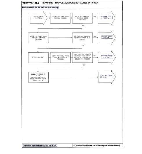

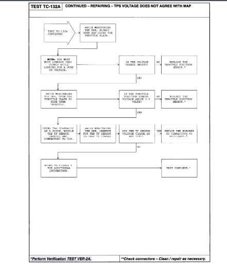

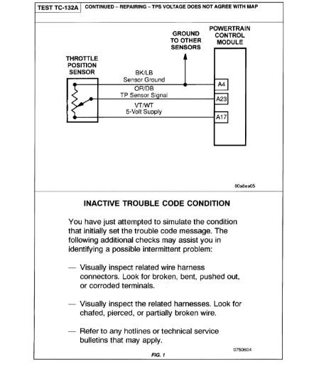

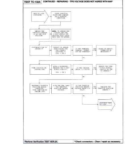

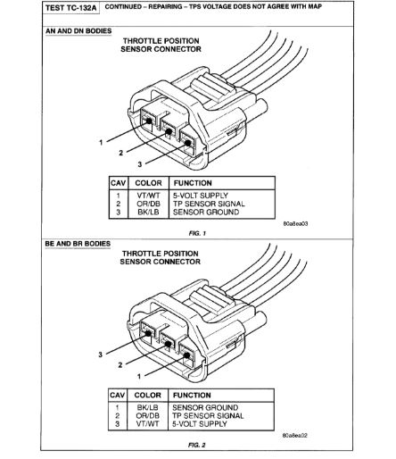

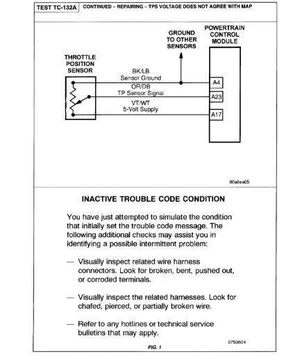

Okay, this is for the TPS sensor voltage too low.
I attached the flow chart for you to follow to determine the failure.

What does that mean a short in a wire or bad sensor?
Tuesday, September 24th, 2019 AT 12:11 PM
MECHANIC
52,796 POSTS
A short is 2 wires touching together that should not be touching.
A bad sensor is one of the sensors not registering correctly due to an internal failure.
Tuesday, September 24th, 2019 AT 12:14 PM
STARLORD1976
MEMBER
173 POSTS
What does it mean if TPS voltage is too low then?
Tuesday, September 24th, 2019 AT 12:17 PM
MECHANIC
52,796 POSTS
The reading is not correct. That's why you need to follow the flow chart.
