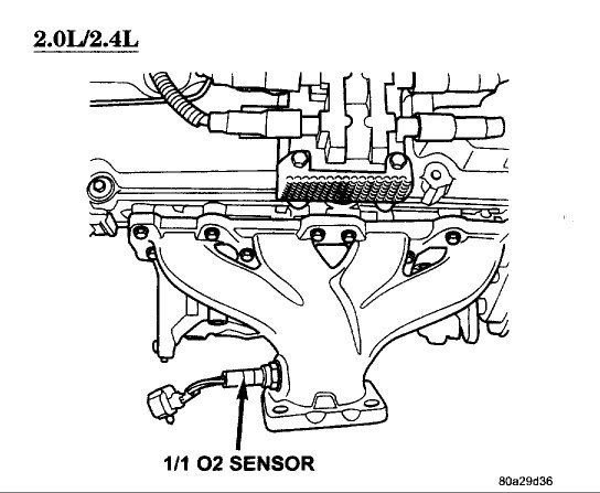

I want to know where they are located.

The upstream sensor will be on the exhaust manifold and the down stream will be on the catalytic converter. Here is a guide to help you step by step with instructions in the diagrams below to show you how on your car.

Look at the exhaust manifold it will be the only sensor on it. Look for wires going to it.
Run the engine before trying to remove it to heat it up.

Two. One on the exhaust manifold, driver's side as I recall, and one right behind the catalytic converter. Here is a guide that will help you change them out with the oxygen sensor locations in the diagrams below.

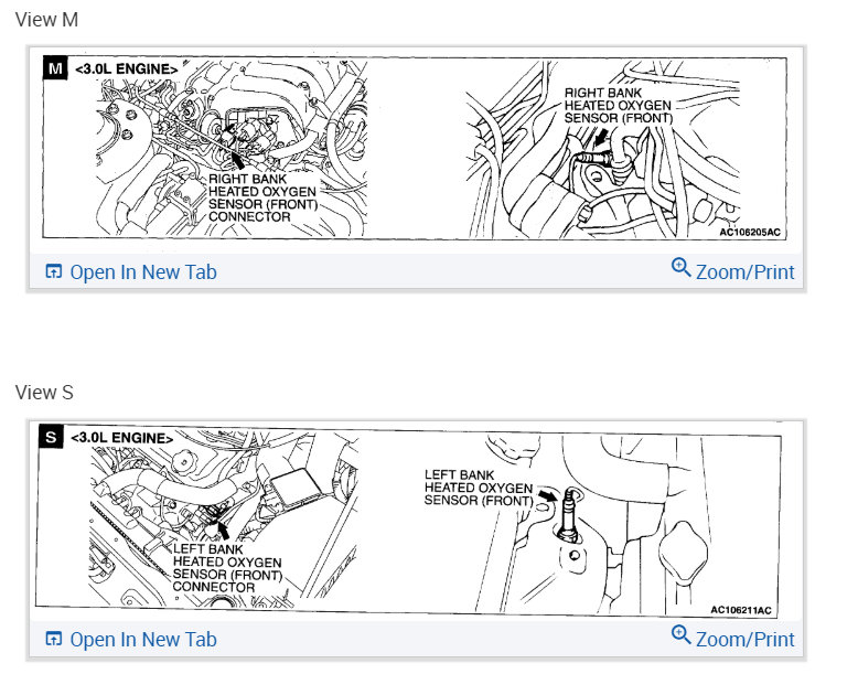

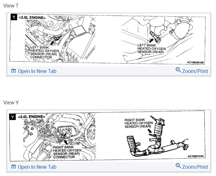

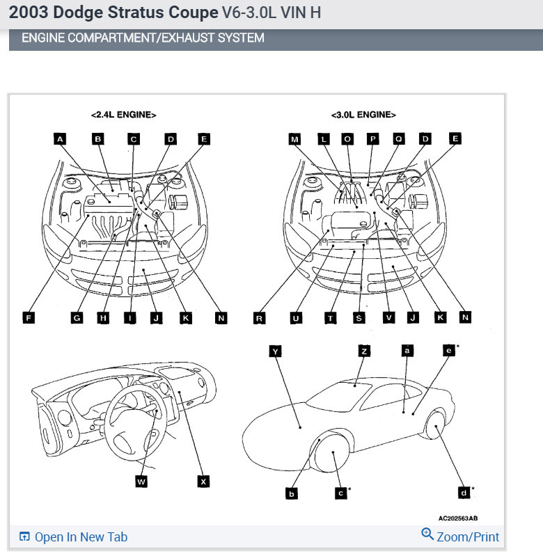

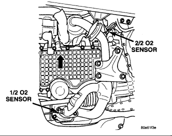

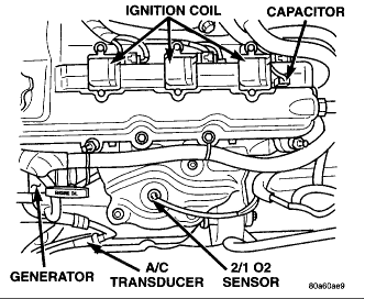

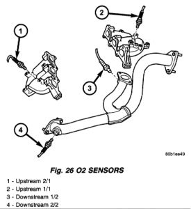

I am throwing error code P0154 02 Sensor Circuit No Activity Detected Bank 2 Sensor 1. I need a diagram to see which one to replace. Also, is this sensor in the rear? Meaning before the catalyst converter? Or after the catalyst converter? Thanks
Thursday, December 3rd, 2020 AT 10:29 AM (Merged)
IMPALASS
  • 3,112 POSTS
Hello
The info you requested. In the future please ensure you provide the specifics on the engine size in Liters and the 8th digit of the VIN
Information is for a 2.7L
https://www.2carpros.com/forum/automotive_pictures/248015_1_42.jpg
https://www.2carpros.com/forum/automotive_pictures/248015_2_28.gif
https://www.2carpros.com/forum/automotive_pictures/248015_3_21.gif
LETHAL
I forgot to add, its a 2001 dodge stratus r/t 3.0liters V6

IMPALASS
  • 3,112 POSTS
Left bank (exhaust manifold) front sensor
https://www.2carpros.com/forum/automotive_pictures/248015_5_10.jpg

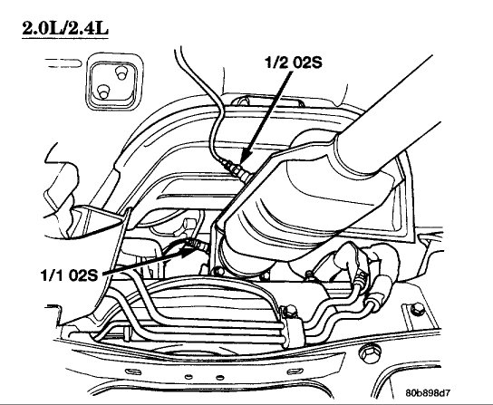

I have a 2000 dodge stratus 2.4L. I think the o2 sensors need replaced and I was wondering where they are located with a diagram or explanation. Thank you.
Thursday, December 3rd, 2020 AT 10:30 AM (Merged)
CARADIODOC
  • 34,462 POSTS
In the exhaust pipe. One is right before the catalytic converter and one is after it. What makes you think they need to be replaced? Has the Check Engine light turned on. Just curious; why does everyone write "need replaced" instead of "needs replacing" or "needs to be replaced"? I see that a lot but only on the internet.

I didn't know this was an english forum sorry. So one person says one and the other says two who's right. Any diagrams would help.

CARADIODOC
  • 34,462 POSTS
It's not an English forum. I'm just wondering why so many people are using the same wrong terminology over and over and finally decided to ask. Since 1996 models, all cars sold in the U.S. Have the OBD2 (on-board diagnostics version 2), emissions system which includes a sensor like normal in front of the catalytic converter to fine tune the fuel / air mixture. The second one added after the converter is to monitor the catalyst efficiency. The front one will switch between "rich" and "lean" multiple times per second. When the converter is working properly the exhaust gas leaving it will switch very slowly, perhaps as little as once or twice every few minutes. When the converter stops working no change takes place in the composition of the exhaust gas so the second, (downstream) sensor switches faster. When it approaches the switching rate of the front sensor the computer knows no change is taking place in the gases, it sets a related diagnostic fault code in memory, and turns on the Check Engine light.
