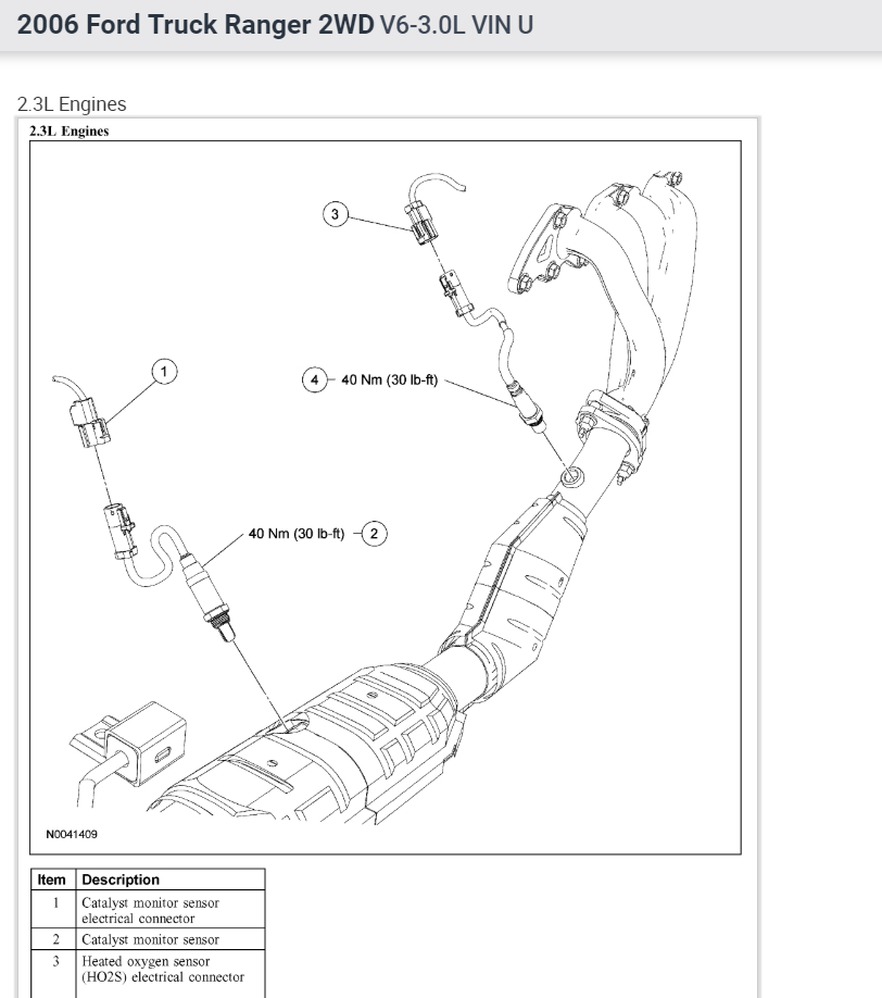

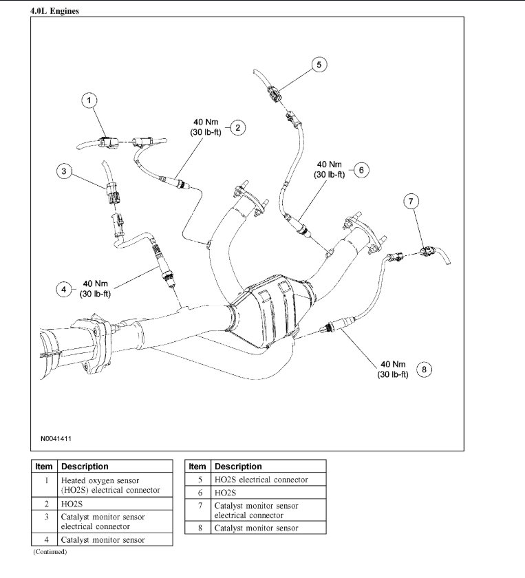

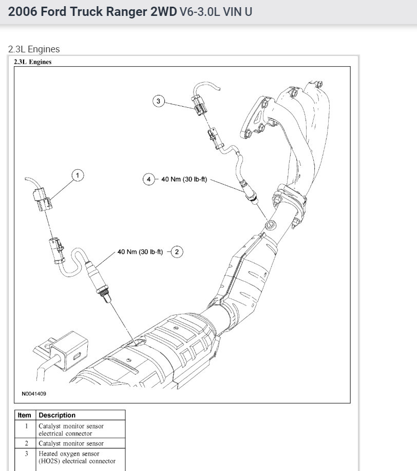

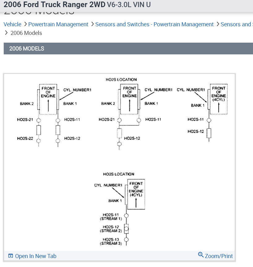

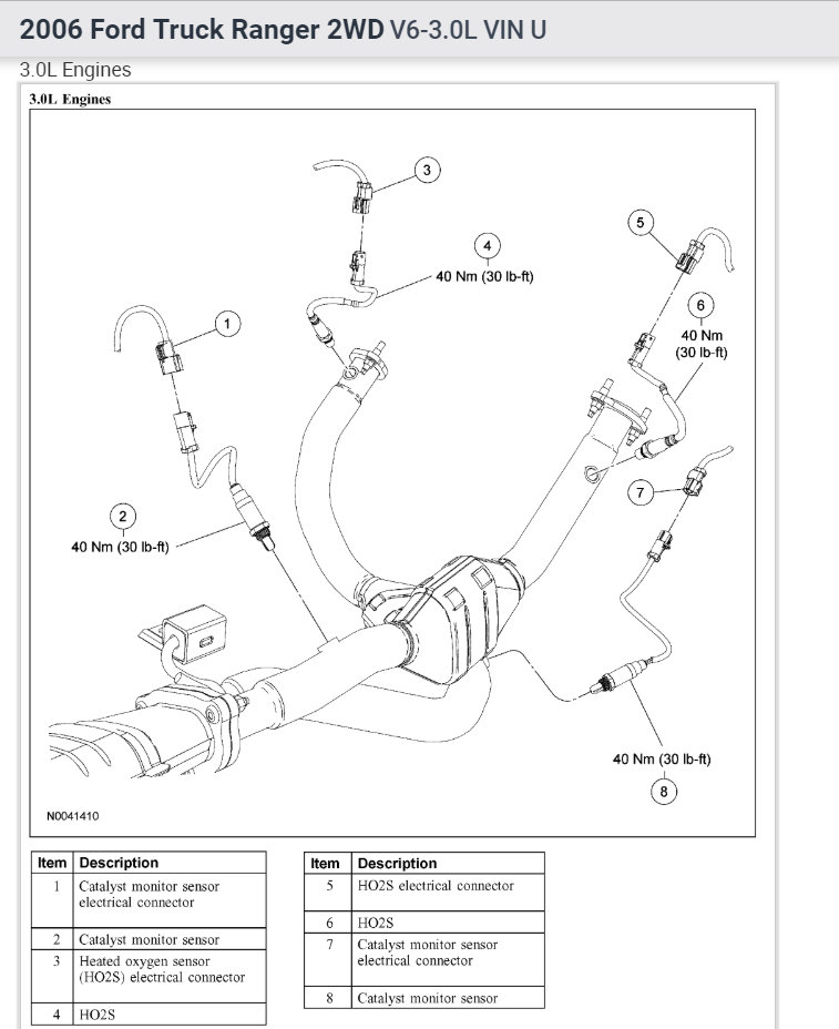

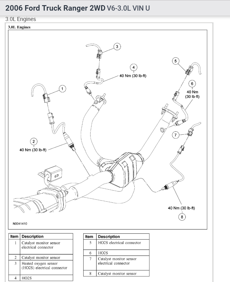

Where is the oxygen sensor located on a 2006 Ford Ranger 3.0?
Tuesday, March 1st, 2016 AT 1:13 PM
CARADIODOC
MECHANIC
34,463 POSTS
There should be four of them; two ahead of the catalytic converters and two after them.
