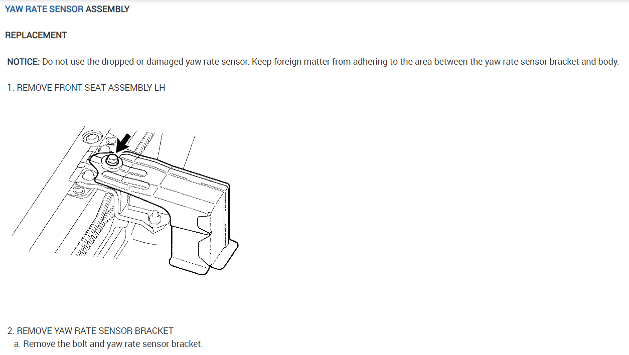

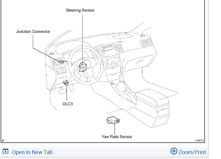

Code is C1244, I have bn trying to locate the sensor on the vehicle, the ABS and brake lights are on the instrument cluster.
Wednesday, September 25th, 2024 AT 11:43 PM
6 Replies
KEN L
  • MASTER CERTIFIED MECHANIC
  • 55,499 POSTS

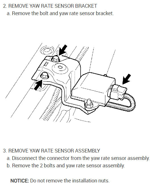

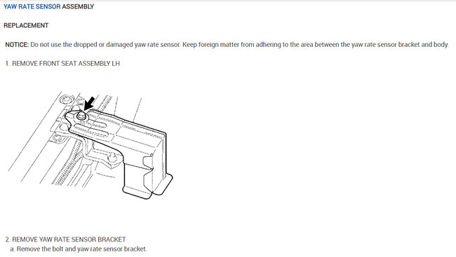

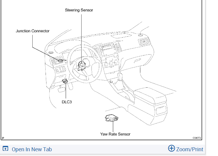

The C1244 code on a 2005 Toyota Corolla indicates a problem with the Yaw Rate Sensor. This sensor is on the left side of the center console. I would check the electrical connector for corrosion because it can get wet and stop working. Clear the codes once the repair is complete. Check out the images (below). Please let us know what happens.

SUP BOY
Can’t still find the sensor at that location?

Did you click on the images in the post above? It shows where the location to the Yaw sensor is.

SUP BOY
I have checked where you as me to check but didn’t find anything there

It is under the driver's seat, it might be under the carpet.
