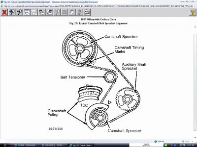

I have a 1987 cutlass cierra with a 4 cylinder 151engine. I replaced head gasket. Need to know how to time valves in.

I'm not sure if you are asking about the timing belt? Set the marks up like the picture shows, #1 piston should be at TDC...
