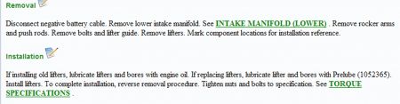

3) What are steps to replace hydaulic lifters? Does it require engine removal from car?
If not, I'm pretty handy with cars and can guess the steps: But, have never done this before
A - remove valve cover
B - remove rocker arm
C - remove pushrod
D - remove lifter - special tools required?

Other than mystery oil, use about 1 quart, no oil additves, and check the pump pressure, if low lifters will be noisy. When and if the lifters quiet down with mystery oil, change the oil and filter and fill. I don't think you need any special tool, tho they do make a lifter remover...
